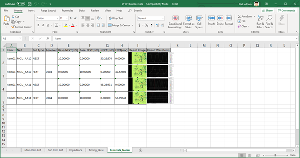

The PollEx DFE+ results can be outputted to a well-formatted MS/Excel spreadsheet.

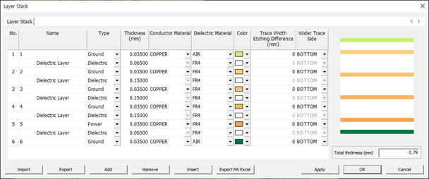

Build PCB Stack
From the menu bar, click Properties > Layer Stack.
The Layer Stack Manager dialog opens.
Click Import.
The Explorer dialog opens.
Find the directory path of your own stack-up files in the navigation tree
section.
You will use the training.udls file from C:\ProgramData\altair\PollEx\<version>\Examples\Verification\DFEP\Stackup. PollEx also provides a default stack-up, the path is: Install Directory\Data\Layer.
- Select training.udls for this 6-layer stack-up.
Click OPEN to load and close the
Explorer dialog.
Your stack-up should now look as follows:
Figure 1. - Click OK to close the Layer Stack Manager dialog.

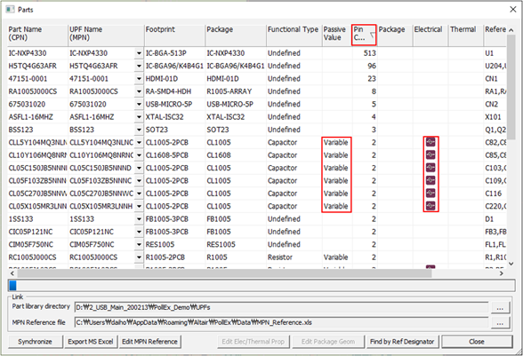

From the menu bar, click Properties > Parts.
The Parts dialog opens.
Sort the result by double-clicking Pin Count.
The passive component RLC values are automatically extracted from PDBB data, if the value property was correctly assigned in the PDBB database. The passive value types of the passive component are classified into variable and fixed.

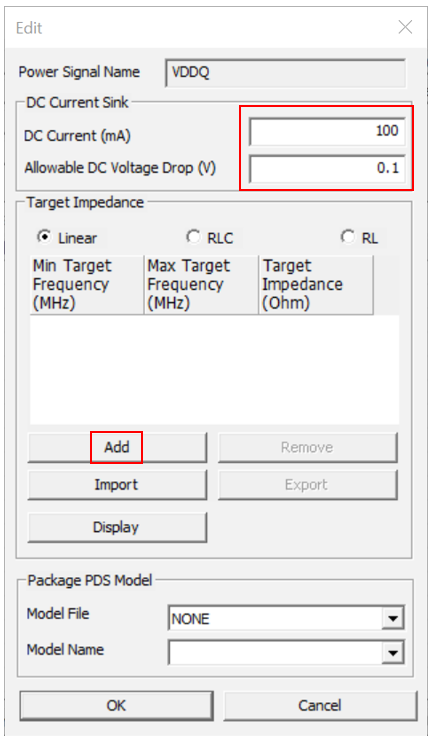

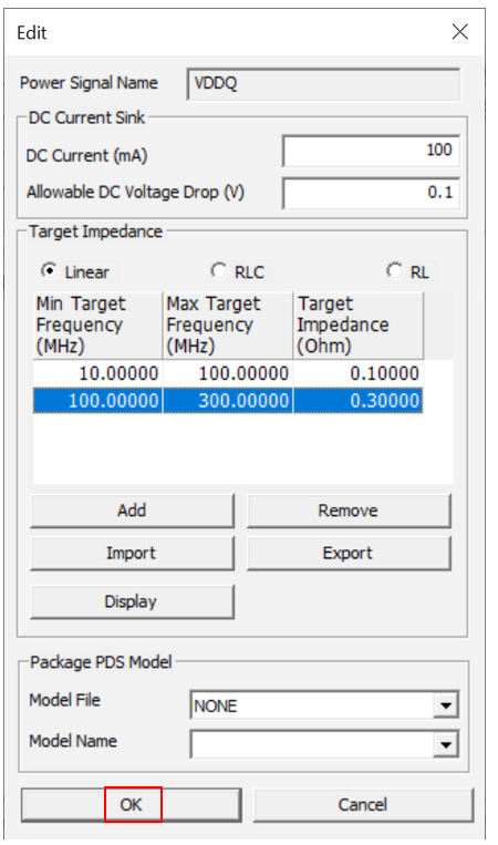

Setup Power Information.
Click Power Rails.
The Power Rail dialog displays. All the power rails used for this component are displayed in the middle of this dialog.
Click the VDDQ power rail.
Figure 4.The Edit dialog opens. - Enter 100 for the DC Current.
Enter 0.1 for the Allowable DC Voltage
Drop.
Your settings should now look as follows:
Figure 5. -
Click Add to setup Target Impedance.
The first row of the target impedance field is added.
- Enter 10 for the Min Target Frequency.
- Enter 100 for the Max Target Frequency.
- Enter 0.1 for the Target Impedance.
Click Add.
The second row of the target impedance field is added.
- Enter 100 for the Min Target Frequency.
- Enter 300 for the Max Target Frequency.
Enter 0.3 for the Target Impedance.
Figure 6. - Click OK to close the Edit dialog.

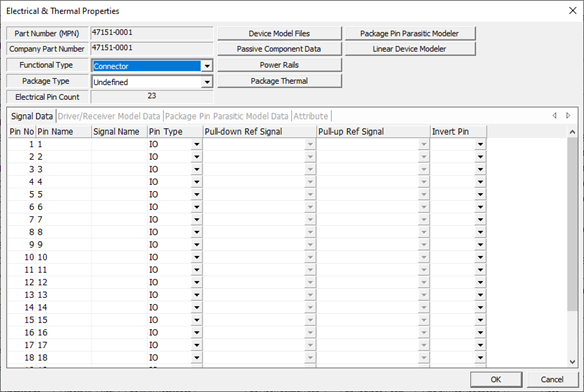

Double-click the part 47151-0001 in the dialog invoked
by clicking Properties > Parts.
The Electrical & Thermal Properties dialog opens.
Select Connector for the Functional Type.
Figure 8. - Click OK to close the Electrical & Thermal Properties dialog.

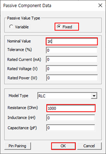

Assign Passive Component Data to R and C
Double-click the part RC1005J101CS in the
Parts dialog.
The Electrical & Thermal Properties dialog displays.
Click Passive Component Data in the Electrical
The Passive Component Data dialog opens.
- For Passive Value Type, select Fixed.
- Enter 1K for Nominal Value.
Enter 1000 for the Resistance (ohm).
Figure 9. - Click OK to close the Passive Component Data dialog.

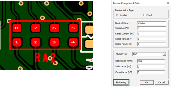

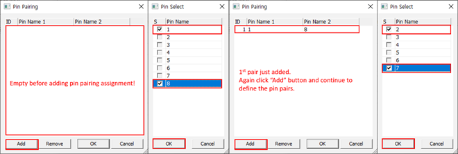

Assign Passive Component Data to Array R and C
Figure 10.

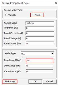

- Double-click the RA1005J000CS part that has more than two pins in the Parts Dialog.
Click
for the Functional Type and select Resistor.
- Click Passive Component Data in the Electrical & Thermal Properties dialog.
Enter 100 ohm for the Resistance.
Figure 11. - Click Pin Pairing in the Passive Component Data dialog to open the Pin Pairing dialog.
Click Add to define pin pairs.
The specified passive component values are assigned separately to these paired pins.

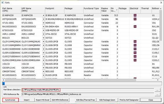

Assign Part Property from UPE
In this step, you will import all required PART properties from Unified Part Editor (UPE).
The unified parts created by PollEx UPE can have versatile information, such as electrical buffer model, package thermal parameters, and 3D package geometry, which is needed for electrical, thermal, and 2D/3D assembly analysis (by PollEx DFA and PCB assembly viewer). It is stored in specific folders in local or server systems.
The Parts Manager dialog opens.
Click
in the Part library directory menu.
To explore the library path for the unified parts, select the Part
folder and then click OK.
UPF path: C:\<working directory>\Part
Click Synchronize to start assigning the part
properties.
Figure 13.Content names under the UPF Name column denotes that the UPF file exists under the local Parts folder for those parts.- The icon under the Package column denotes that 3D package geometry is linked with the unified part.
- The icon under the Electrical column denotes that the electrical buffer model is called from the unified part.
- The icon under the Thermal column denotes that thermal information is called from the unified parts.
- Click Close to close the Parts dialog.

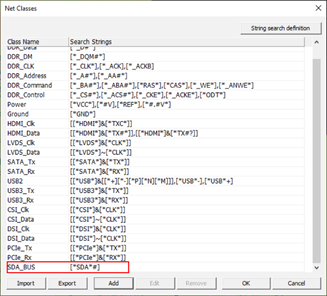

Add New Class Item
From the menu bar, click Properties > Net Classes.
The Net Classes dialog opens.
Click Add.
The ADD dialog opens.
- Enter the net class name SDA_BUS in the net Class Name field and type search string *SDA*# in the Search Strings field.
- Click Add String.
ADD dialog.
The SDA_BUS net class is registered in the Net Classes dialog.
Figure 14. - Click OK to close the Net Classes dialog.

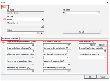

Assign Net Properties for Power
From the menu bar, click Properties > Nets.
The Nets dialog displays.
Double-click VCC1P5_DDR.
The Edit dialog displays.
Select the Net Type as Power, enter
1.5 for the Voltage, and click OK.

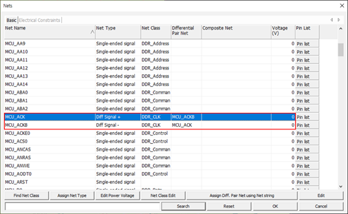

Assign Net Properties for Differential Pair

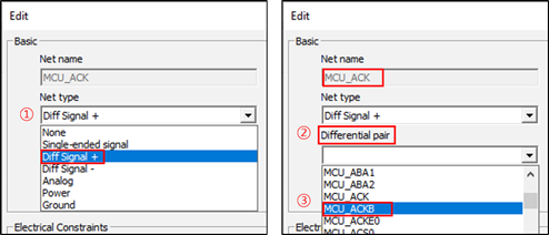

Double-click MCU_ACK.
- Change the Net Type to Diff Signal +.
Select the other pair net MCU_ACKB as Diff Signal using
the scroll bar.
Figure 16. -
Edit dialog.
You will find that the MCU_ACK net and MCU_ACKB net are combined as a differential pair net.

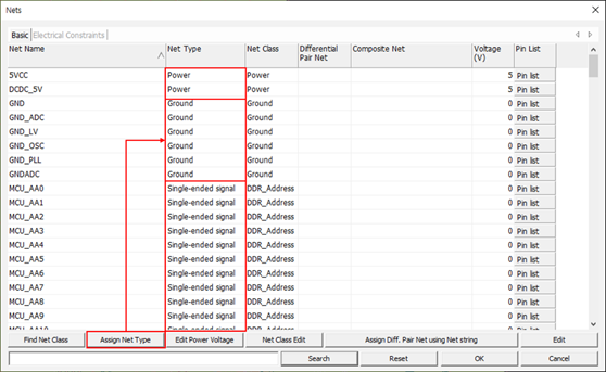

Assign Net Properties Automatically
Click Assign Net Type.
The PollEx DFE+ sets the properties for all nets automatically using net information described in IBIS files and property.
Figure 18. - Click OK to close the Nets dialog.

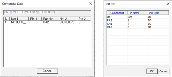

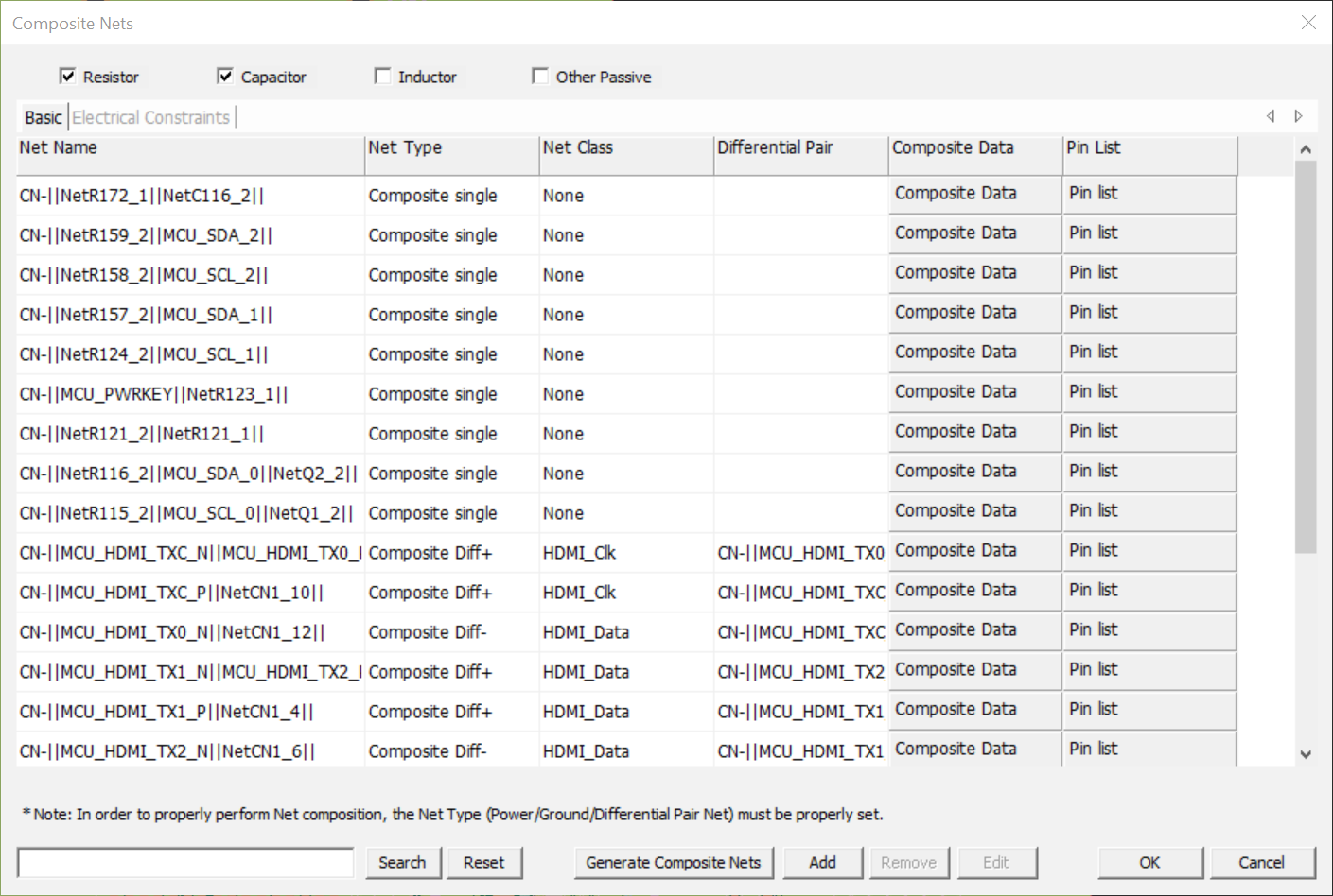

Create Composite Net
- From the menu bar, click Properties > Composite Nets.
- Activate the Resistor and Capacitor checkboxes.
Click Generate Composite Net.
You can specify nets that should not be composited with other nets such as Power and Ground nets.The Selects Nets to Exclude dialog opens.
Click OK and check the listed
composited nets.
Figure 19.
Figure 20. -

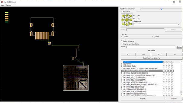

Select the composite net
CN-||MCU_HDMI_HPD||NetCN1_19||.
The secondly listed composited net above configured with MCU_HDMI_HPD and NetCN1_19 displays at the beginning of this composite net chapter having R85 resistor.
Figure 21. - Close the Net 2D/3D Viewer dialog.

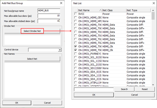

Click Add to generate a new bus group.
The Add Net Bus/Group dialog opens.
- Enter HDMI_BUS in the Net bus/group name field.
- Enter 10 in the Max allowable bus skew(ps) field.
- Enter 10 in the Max allowable strobed skew(ps) field.
Click Selected Strobe Net to select strobe net.
The Net List dialog opens.
- Select the CN-||MCU_HDMI_TXC_N|| and CN-||MCU_HDMI_TXC_P|| nets as a strobe net.
Click OK to close this
dialog.

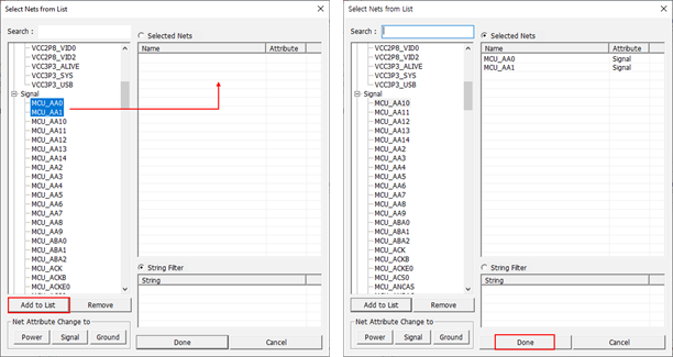

Click Select Net to select belonging net.
- Select the other HDMI nets except the clock net as the belonging nets.
- Click OK to close this dialog.

dialog.
The HDMI_BUS group is registered as a new bus group with the name HDMI_BUS.

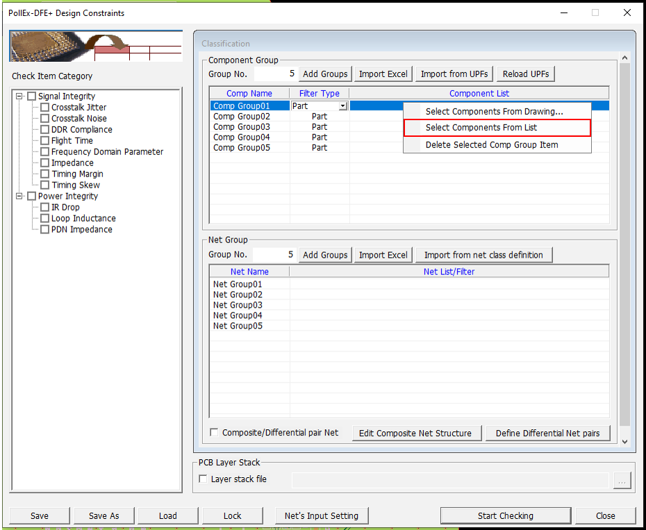

From the menu bar, click Option > DFE+ > Input to launch PollEx DFE+.
The PollEx DFE+ Design Constraints dialog opens.
Define CPU component group.
- In the Component Group Type section, click Component Group01 and change the group name to CPU by double-clicking the Name column.
- In the Type section, select PART from the drop-down menu.

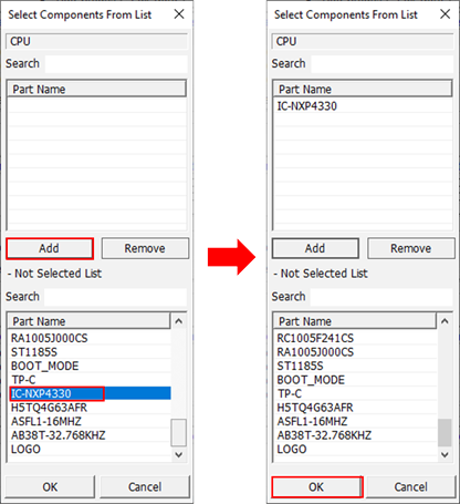

Click the CPU component group that was created
and select Select Components from List from the
context menu.
Figure 23.
- Select the IC-NXP4330 component from the part name list in lower section.
Click Add to add selected component to selected
item.
Figure 24. - Click OK.

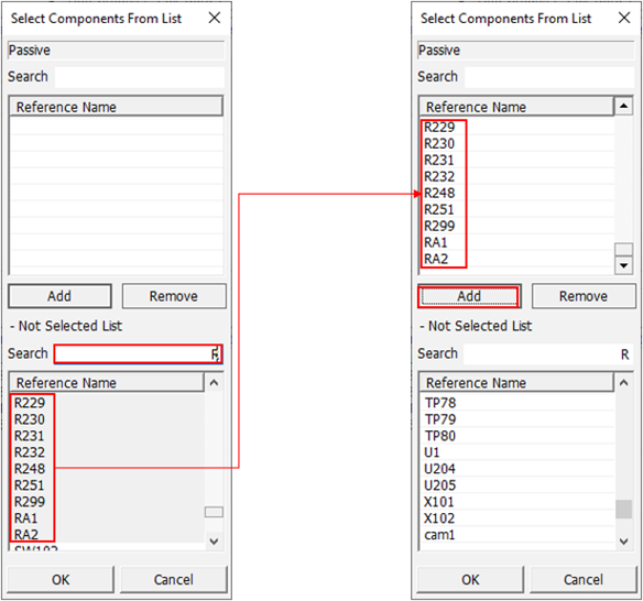

Define Passive component group.
- In the Component Group Type section, click Component Group02 and change the group name to Passive by double-clicking the Name column.
- In the Type section, select Reference from the drop-down menu.
Click the Passive component group that was
created and select Select Component from List
from the context menu.
The Select Components from List dialog opens. This menu will show you the reference name list.
Enter R in the search field, select the
Resistor component, and click
ADD.
The highlighted items will be moved to Reference name field.

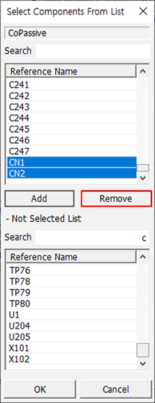

Figure 25. - Enter C in the search field, select the Capacitor component, and click ADD.
In the Reference Name field, select CN1 and
CN2 and click
Remove.
Figure 26. -
Enter FB in the search field, select the
Inductor or bead
The highlighted items are moved to the Reference name field.
Enter TP in the search field, select the
test-point component, and click
ADD.
The highlighted items are moved to Reference name field.
- Click OK to close Select Component From List dialog.

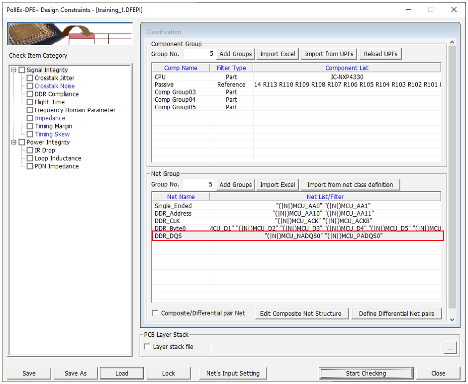

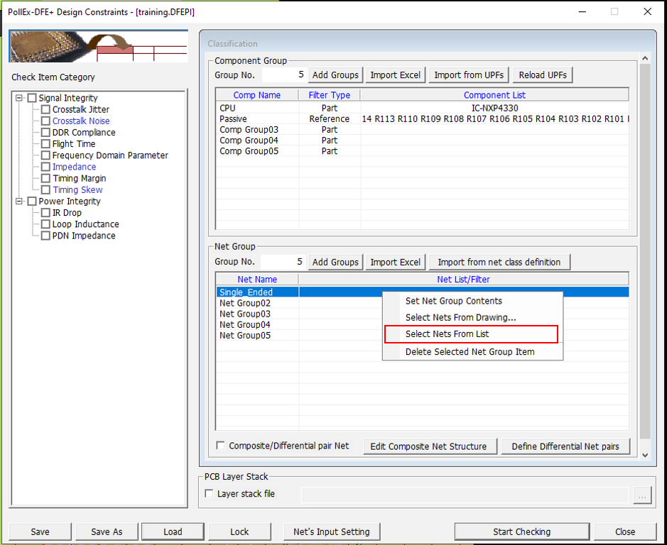

Define Net Group
Define Single-Ended net group.
- In the Net Group section, double-click Net Group01 and change the group name to Single_Ended by double-clicking the Name column.
- In the Type section, select Net from the drop-down menu.
Click the Single_Ended net group that was
created and select Select Nets From List from the
context menu.
Figure 27.
- Select the MCU_AA0 and MCU_AA1 nets from the signal net list.
After net selection, click Add to List to add
the selected net list to the selected item.
Figure 28. - Click Done to close this window.
Define DDR_Address net group.
- In the Net Group section, double-click Net Group02 and change the group name to DDR_Address by double-clicking the Name column.
Click the DDR_Address net group that was created
and select Select Net List from the context menu.
The Select Net from List dialog opens.
- Select the MCU_AA10 and MCU_AA11 nets from the signal net list.
- Click Add to List to add the selected net list to the selected item.

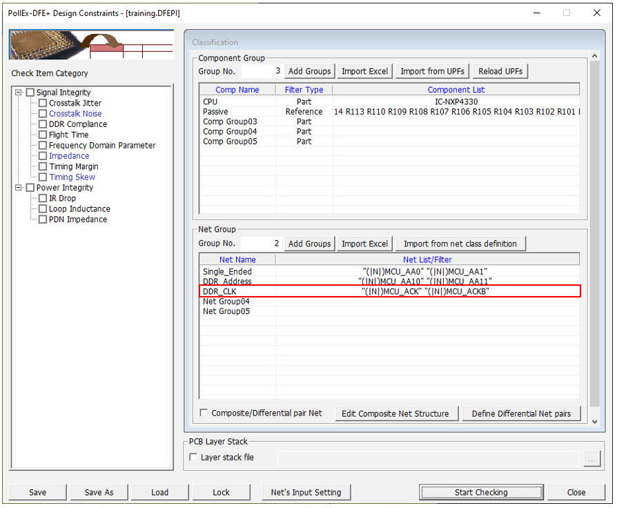

Define DDR_CLK net group.
- In the Net Group section, double-click Net Group03, and change the group name to DDR_CLK by double-clicking the Name column.
Click the DDR_CLK net group that was created and
select Select Net From List from the context menu.
- Select the MCU_ACK and MCU_ACKB nets from the signal net list.
In the Net Group section, your net group setting should now look as follows.
Figure 29.

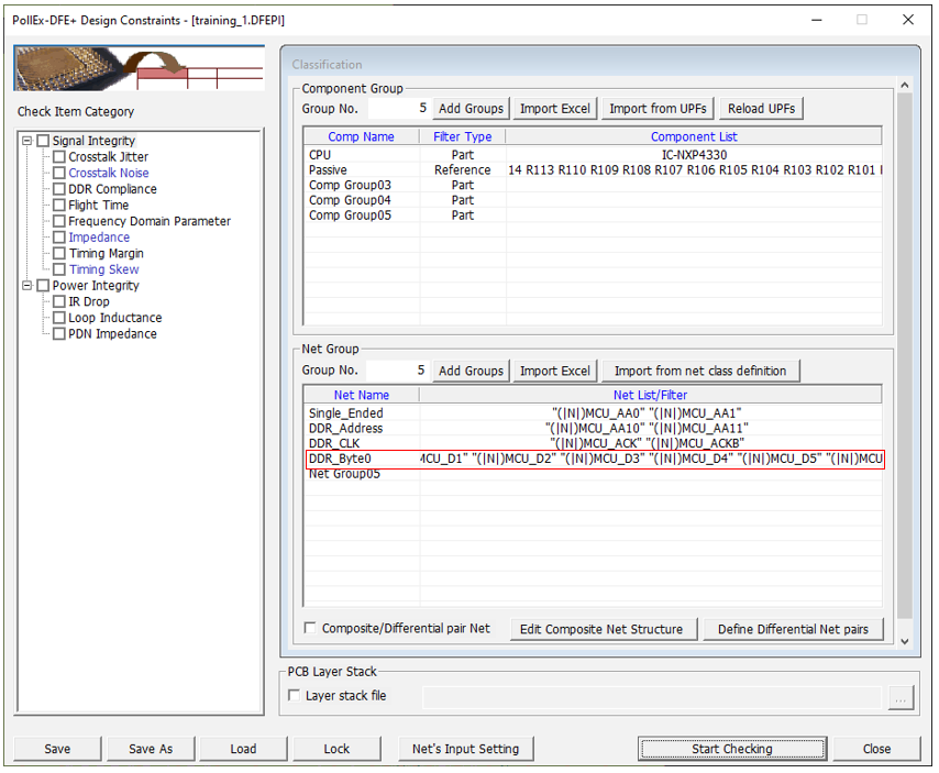

Define DDR_Byte0 net group.
- In the Net Group section, double-click Net Group04, and change the group name to DDR_Byte0 by double-clicking the Name column.
Click the DDR_Byte0 net group that was created
and select Select Net From List from the context menu.
- Select MCU_D0 ~ MCU_D7 from signal net list.
In the Net Group section, your net group setting should now look as follows:
Figure 30.
Define DDR_DQS net group.
- In the Net Group section, double-click Net Group05, and change the group name to DDR_DQS by double-clicking the Name column.
Select the DDR_DQS net group that was created
- Select the MCU_NADQS0 and MCU_PADQS0 nets from the signal net list.
Figure 31.

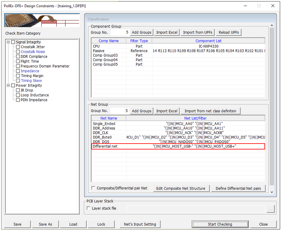

Define Differential net group.
To add a line to the Net Group table, enter 1 in
the Group No. field, and click Add Groups.
An additional line is added in the Net Group table.
- In the Net Group section, double-click the newly added line, and change the group name to Differential by double-clicking the Name column.
Click the Differential net group that was created and select
- Select the MCU_HOST_USB- and MCU_HOST_USB+ nets from the signal net list.
Figure 32.

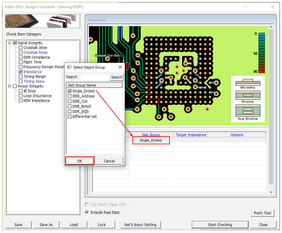

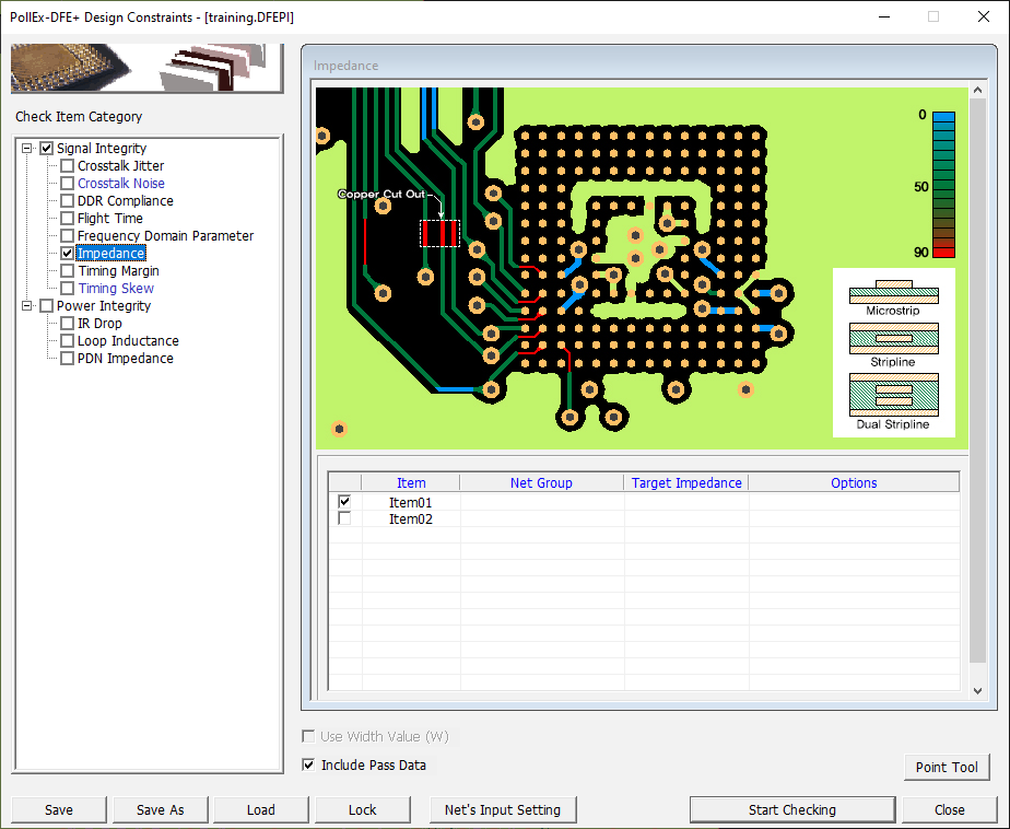

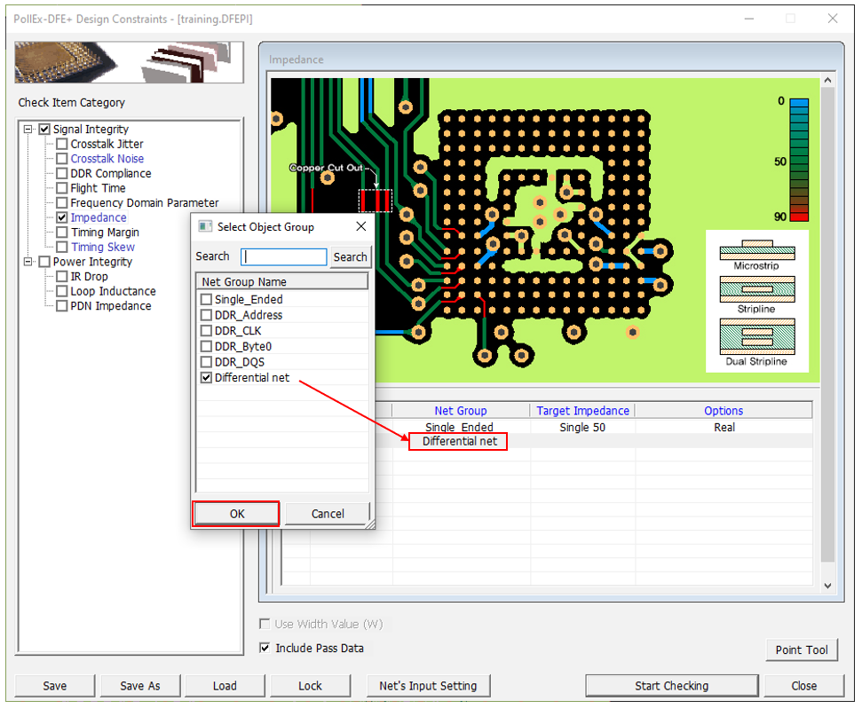

Check Impedance
Enable the Impedance checkbox.
The PollEx-DFE+ Design Constraints dialog opens.
Figure 33.
Set Impedance test condition.
Double-click the Net Group field of the first
item.
The Select Object Group dialog box opens.
Select the Single_Ended net group and click
OK.
Figure 34.

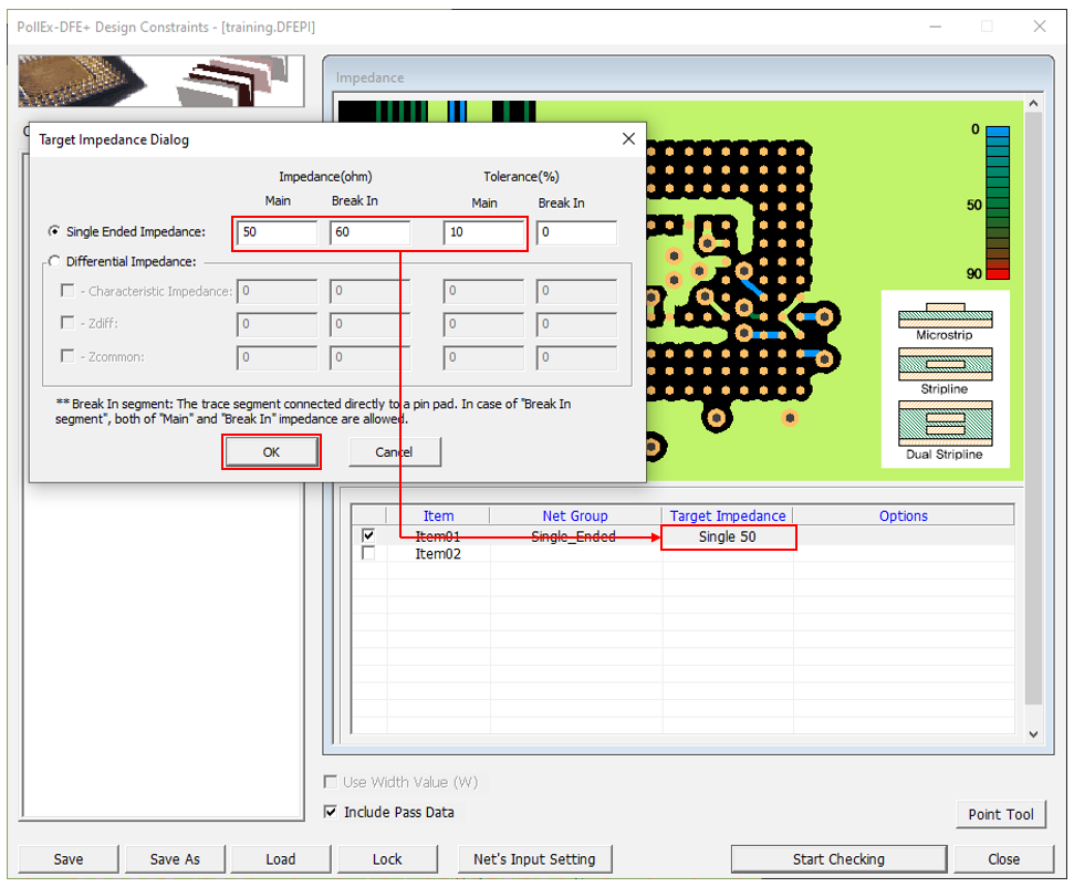

Double-click the Target Impedance field of the
first item.
The Target Impedance dialog opens.
- Enter 50 for Main.
- Enter 60 in the Break In.
- Enter 10 in the Tolerance of Main.
Click OK.
Figure 35.

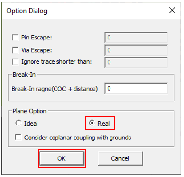

Double-click the Option field of first
item.
The Option dialog opens.
For Plane Option, select Real.
Figure 36.
Click OK to close
this dialog.
With this setting, PollEx DFE+ will check if the impedance of MCU_AA0 and MCU_AA1 signal is within target impedance range.
item.

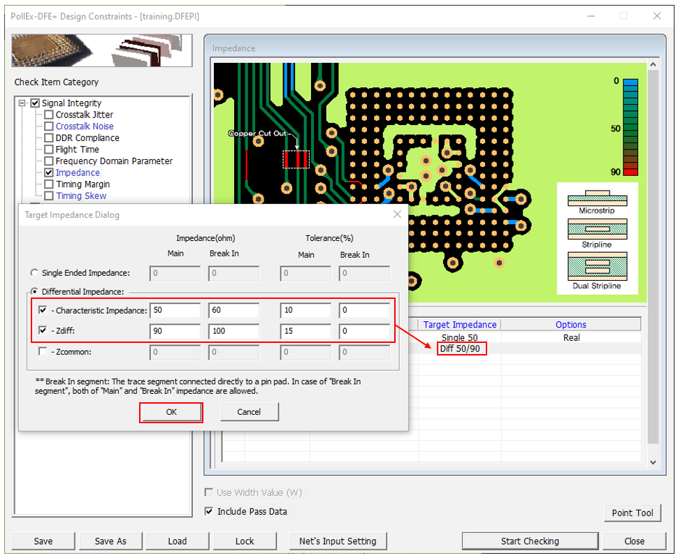

Define differential net impedance check condition.
Double-click the Net Group field of the second
item.
The Select Object Group dialog opens.
Select the Differential net group and click
OK.
Figure 37.
first item.
The Target Impedance dialog box opens.
item.
Setup Characteristic impedance of differential line.
- Enter 60 for Break In.
- Enter 10 for Tolerance of Main.
Setup Differential impedance of differential line.
- Enter 90 for Main.
- Enter 100 for Break In.
- Enter 15 for Tolerance of Main.
Click OK.
Figure 38.
Double-click the Option field of the first
item.
Figure 39.
Click OK.
With this setting, PollEx DFE+ will check if the differential impedance of MCU_HOST_USB- and MCU_HOST_USB+ differential pair is within target impedance range.

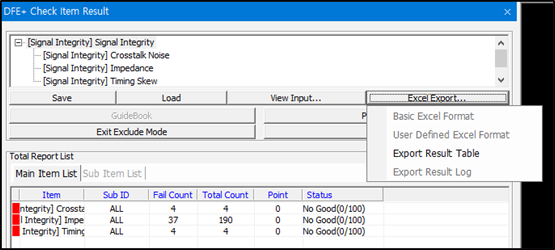

Run Impedance Item and review Check Result.
Click Save As and save the input file as
training.DFEPI in the PollEx
DFEP folder under the job folder.
You can reload this input setup condition by clicking Load.

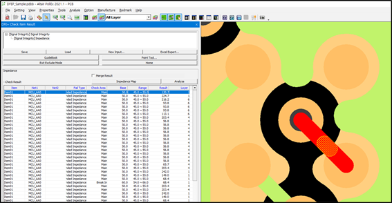

Click Start Checking.
PollEx DFE+ starts checking for selected checking items. PollEx DFE+ changes the window for results display.
In the Result tab, select [Signal Integrity]
Impedance and choose the first error checking
item.
Figure 40. -
In the result tab window, click View
Input.

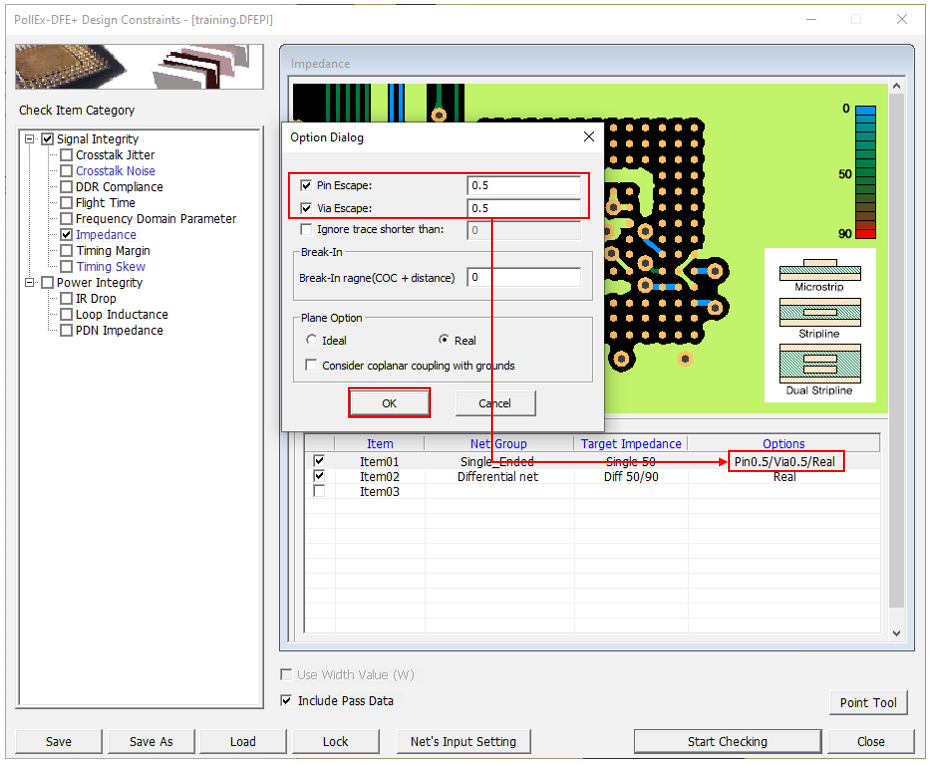

In the Check Item Category section, click the
Impedance item to set the test
condition.
The Impedance item rule entry dialog opens.
Double-click the Options field of the first
item.
- Enable the Pin Escape checkbox and enter 0.5 in the value field.
Enable the Via Escape checkbox and enter
Figure 41.
- Click OK to close Option dialog.
PollEx DFE+ prompts you to save current input file status or not.
Click Save.
PollEx DFE+ starts checking with new input condition.
In the result tab, select Impedance and review
the result item.
The previous 1st case error is removed.
- Select other checked items and review the results.

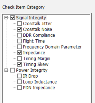

Check Timing Skew
- Preview Timing Skew item.
In the result tab window, click View Input.
Enable the Timing Skew checkbox in the Check Item
Category list.

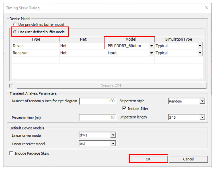

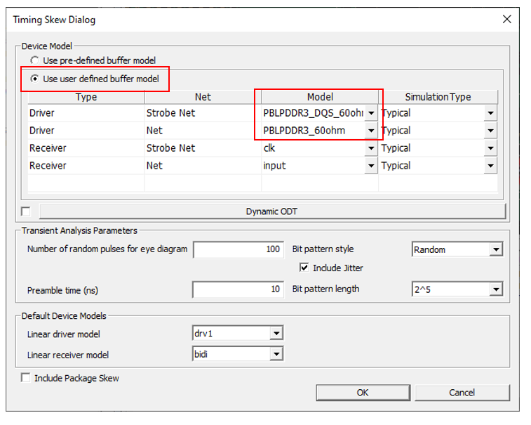

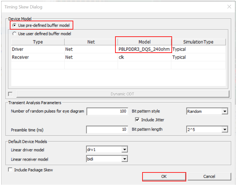

Click the Analyze Option field in the
Timing Skew Input Setup dialog to setup
simulation environment.
The Timing Skew dialog opens. You can change the actual driver pin model among selectable models.
Figure 42. -
Select Use user defined buffer model.
If you check Use pre-defined buffer model, default Driver and Receiver models from UPE will be used.
In the Model field for Strobe Net, click
and select PBLPDDR3_DQS_60ohm.
In the Model field for Net, click
and select PBLPDDR3_60ohm.
In the Model field for Receiver Strobe Net, click
and select clk.
In the Model field for Receiver Net, click
and select input.
- Click OK to close Timing Skew dialog.

Click the Analyze Option field to setup a
Figure 44. -
Click Use pre-defined buffer model.
The default Driver and Receiver models from UPE will be used.
Check Timing Skew.
- Disable the Impedance checkbox in the Check Item Category section.
Figure 45.

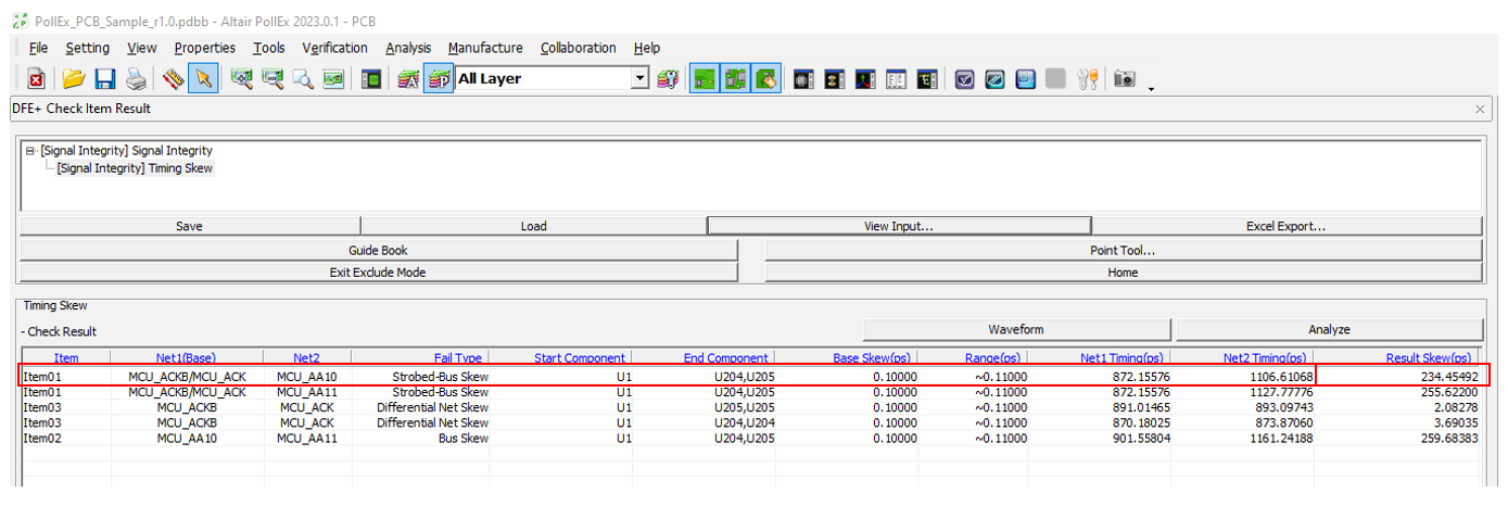

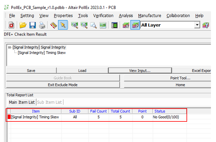

PollEx DFE+ starts checking for selected checking items. After running, PollEx DFE+ changes the window for results display.
In the result tab, click the [Signal Integrity] Signal
Integrity item to see the detailed result.
Figure 46.
Review the Timing Skew Check Result.
In the result tab, select [Signal Integrity] Timing
Skew to see the detail result.
Figure 47. -
Choose the first error checking item of this section.
The MCU_AA10and MCU_ACK nets are highlighted in right side window. The Waveform Viewer dialog opens.
- Click Close.
Select the first error item and click
Analyze.
The Network Analysis dialog opens. You can modify the simulation parameter or change the topology to resolve this problem. Refer to the SI or SI Tutorial for more details.
- Click Close.

Check Crosstalk Noise
- Enable the Crosstalk Noise checkbox in the Check Item Category list.
Set Crosstalk Noise check condition.
Click the Net Group field in the
Crosstalk Noise Input Setup dialog to select a
target net from net group list.
- Select the DDR_Address net group as a target net group and click OK.
- Click FEXT(mV).
- Click the FEXT(mV) field in the Crosstalk Noise Input Setup dialog and enter 10.
- Click NEXT(mV).
- Click the NEXT(mV) field and enter 10.

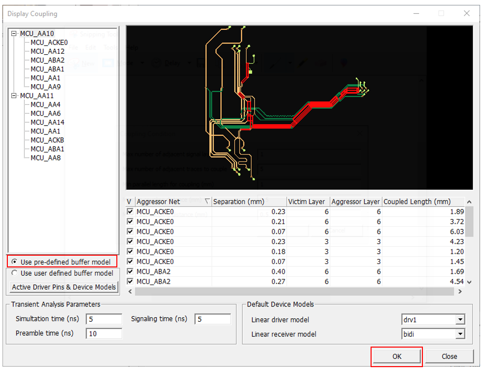

The Display Coupling dialog opens.
Select Use pre-defined buffer model.
Display Coupling dialog.
Figure 48.
Check Crosstalk Noise item.
- Disable the Impedance and Timing Skew checkboxes in the Check Item Category section.
Enable the Crosstalk Noise checkbox.
Figure 49.
- Click Start Checking.
Click Save to save current setup.

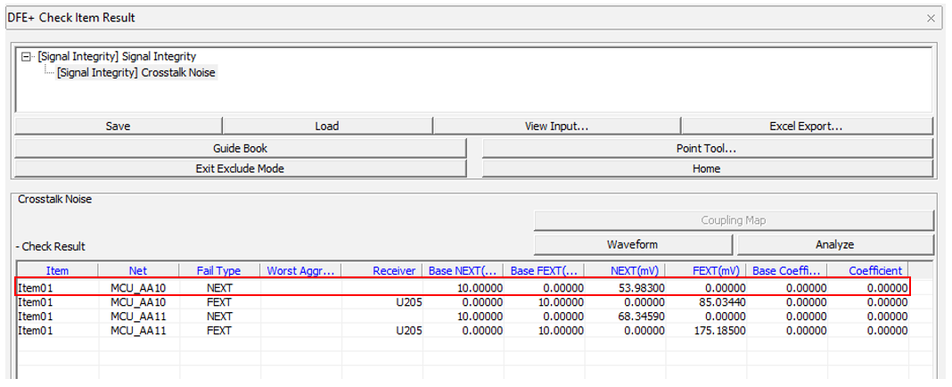

PollEx DFE+ starts checking for selected checking items. After running, PollEx DFE+ changes the window to results display.

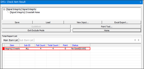

In the result tab, click [Signal Integrity] Crosstalk
Noise to see the detailed result.
Figure 50.
Review the Crosstalk Noise Check Result.
In the result tab, select [Signal Integrity] Crosstalk
Noise to see the detail result.
Click the first error checking item of this section.
The victim net MCU_AA10 net is highlighted in right side window. The Waveform Viewer dialog opens.
- Click Close.

Create Excel Report for Result
In the result tab, click View Input.
Enable the Impedance, Timing
Skew, and Crosstalk Noise checkboxes.
Figure 51. - Click Start Checking.
Click Save.
Click Save.
We can read this result file using the Option > DFE+ > Result menu.

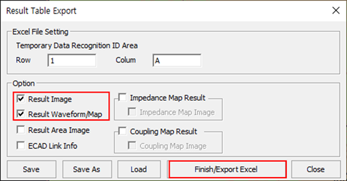

Click Excel Export and select Export Result Table from
the context menu.
Figure 52.The Result Table Export dialog opens. - Enable the Result Image checkbox.
- Enable the Result Waveform checkbox.
Click Finish/Export Excel to start Excel report
creation.
Figure 53.
Figure 54. -
Save this Excel file.
Keep a sample Excel format file for future use.
