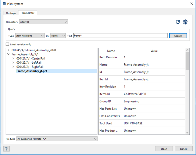

                Query and browse contents.
- Choose they type of query - Item, Revisions, or CAE Model Revisions.
 - Choose to query content by Item, ID, Name, or Revison.
 - Enter text and click Search.
 - Optional:
                        Select Latest revison only to display only the
                            latest revision of a file in the search results.
                        The search results are displayed in the window.You can click the < on an assembly to expand it. You cannot edit properties from this dialog, as they are defined in your PDM system. You can request more properties by right-clicking on an item in the tree and selecting Get more properties in the context menu.
                        Select a file and click Open to import
                            geometry.
                        You can select a master file to open an entire assembly or a single file to open a part.
 - Optional:
                        Filter files based on the file type at the bottom of the window.
                        Only files of the selected type will be imported.
Tip: As an example of how to form a query: to search for Frame Assembly, choose query by Name and enter the text Frame*.
