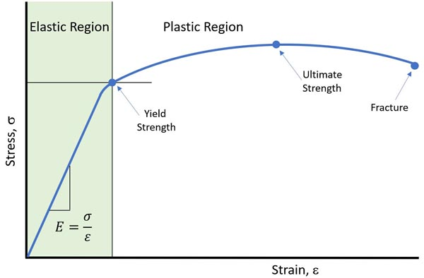

In SimSolid, materials are assumed to remain in the
linear-elastic region of the stress-strain curve for structural analysis. That is,
strains are assumed small (<0.2%) and material properties do not change with load
or time. Figure 1.
