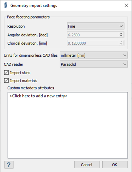

                Check for solids with curvature.
- If the faceting of those solids is coarse, bring in finer resolution of those parts.
 - Do not import the entire assembly with finer resolution, it will slow down the solution considerably.

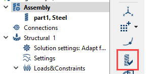

                Check for geometry errors.
Figure 1. Assembly > check geometry error
Figure 2. Settings > Geometry Import Settings -

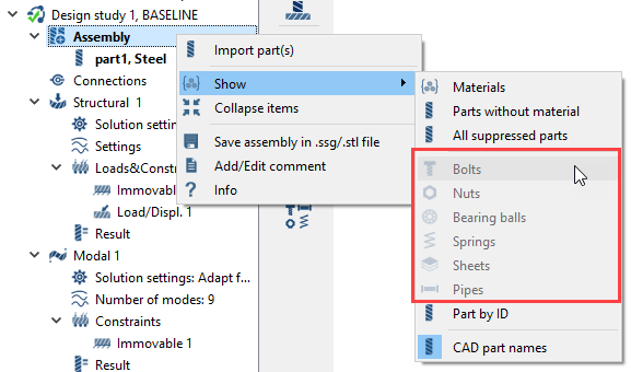

                Make sure parts are classified correctly (bolts, nuts, springs, and so
                    on).
Figure 3. Assembly context menu > Show -

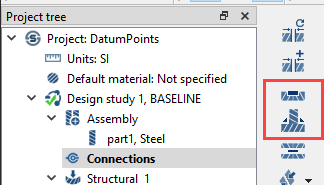

                Create weld connections, if applicable.
                Connections in SimSolid should represent connections of the parts in the field.
                    Figure 4. Connections > Seam/Spot Welds -
                Create auto-connections using normal resolution.

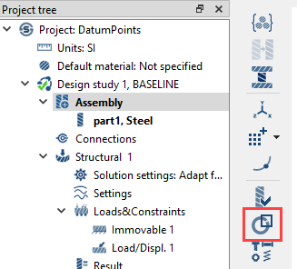

                Review parts with small relative volume.
- Verify that they have enough connection points.
                    Figure 5. Assembly > Review parts -

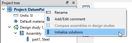

                If project files from older versions are used, it is recommended to reset the
                    project.
- Right-click on the project and choose Initialize solution.
                    Figure 6. Project context menu > Initialize solutions
