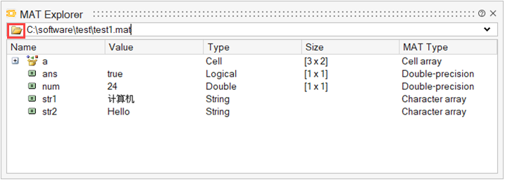

Click the Browse for .mat file icon, select one or more
files, and then click Open.
As the files are being read, the status bar is updated with the
variables read. After the files are read, you can inspect the data tree for
variables.

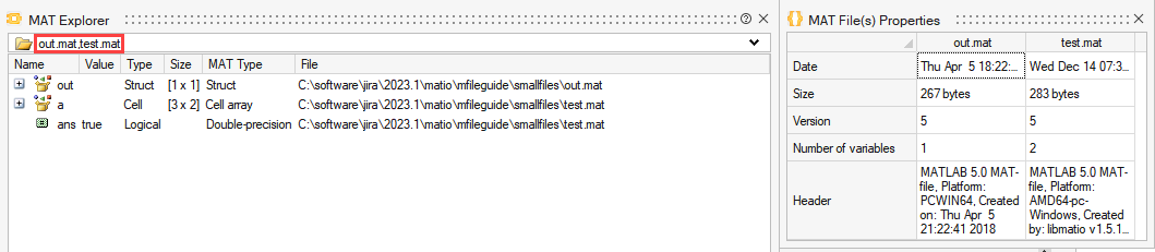

Note: You can load multiple
.MAT files at the same time.
To open .MAT file properties, click the icon to
the right of the file name.

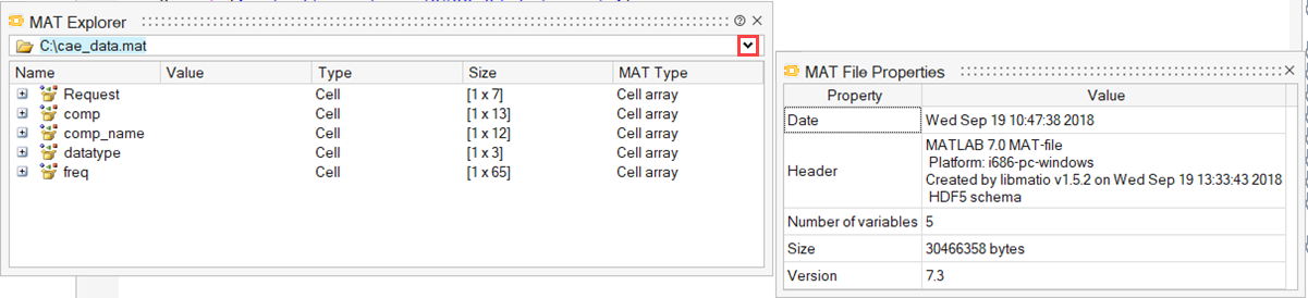

If you right-click on a variable, a context menu gives you options to
load all or only the selected variables in the current Twin Activate session, select or deselect all the variables, and
hide unsupported variables, if any.
Note: If there are unsupported
variables and the context menu item is toggled, unsupported items are shown
as disabled items in the tree.
