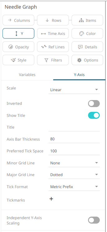

Other visualization-specific properties can be set by clicking on the Y-Axis variable drop area and then selecting the Y-Axis tab:
Setting
Independent Y-Axis Scaling
Determines whether to have each visualization Y-axis in a cross tab automatically scaled independent of the others.
