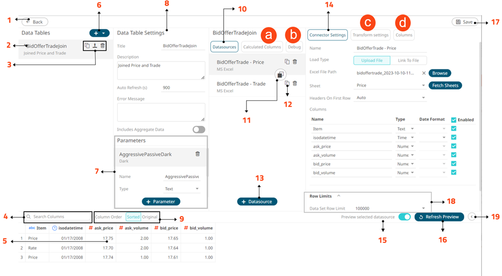

The Workbook Internal Data Table Editor layout is displayed as below, where in this example, there are joined data sources:
Workbook Internal Data Table Editor Sections and Definitions
Section
1
Back
Exit the Workbook Data Table Editor view and go to the Open Workbook in Design Mode view.
2
Data Table
List of data tables. Can be rearranged.
3
Toolbar
After the data is successfully retrieved, three options on the Workbook Data Table Editor layout allows:
·    Making a duplicate of the data table
·    Publishing the data table template
·    Deleting the data table
4
Search Columns
Allows searching of columns on the Data Sources Preview.
5
Data Preview
Executes the queries to return and display preview of the data table you are creating.
NOTE: the maximum number of rows displayed in the Data Preview is 100.
6
Add Data Table or Select Data Template
Add data table or select a data table template.
7
Data Table Parameters
Add or manage data table parameters.
8
Data Table Settings
Definition of the name of the selected data table, description, and the auto refresh period (in seconds). Also allows the retrieval of external aggregates and set custom message to be displayed upon unsuccessful data connection.
9
Group and Sort Columns
When the Column Order is set to Sorted, the columns are grouped by type (Text, Date/Time, then Numeric) and sorted alphabetically.
10
Data Sources
One or more data sources that can be connected to directly, with data retrieved on the fly as it is required. Can be rearranged.
11
Join/Union All Definition
Allows definition of a join or union all of multiple data sources.
12
Duplicate Data Source
Allows creating a duplicate data source
13
Add Data Source
Allows adding data sources from the available data connectors.
14
Connector Settings
Displays the connector settings of the data source and allows for limiting the amount of data to be returned.
15
Preview Selected Data Source
Preview the selected data source on the Data Preview panel.
16
Refresh Preview
Refresh the data sources preview.
17
Save Data Table
Save the data table definition and go to the Open Workbook in Design Mode view.
18
Row Limits Settings
Allows setting of the row limit of data sources.
19
Collapse Data Preview
Collapse the Data Preview pane. Click  to expand the Data Preview pane.

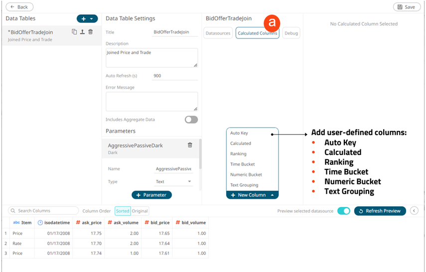

Clicking Calculated Columns    displays the New Column list box.
Option
Add Auto Key
Allows creation of an auto key for the data schema on the Data Sources Preview.
Add New Calculated Column
Allows creation of a calculated column from the existing columns in the data table.
Add New Ranking Column
Allows creation of a new numeric column based on the ranking of columns in your data.
Add New Time Bucket Column
Allows creation of time buckets (categorical time analysis).
Add New Numeric Bucket Column
Allows creation of Identity, Sign, Manual, Equal Density, and Equal Distance columns.
Add New Text Grouping
Allows creation of a grouping based on source text column.

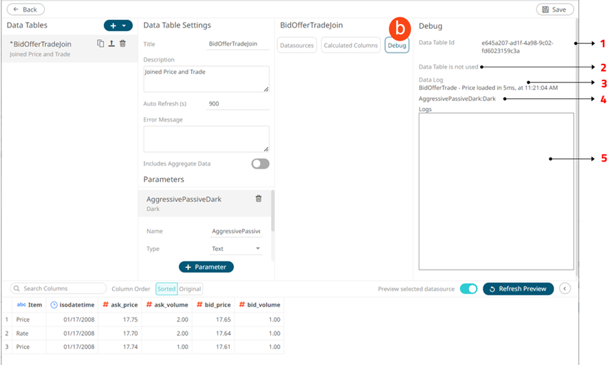

Clicking Debug  displays the Debug pane.
Section
1
Data Table Id
Id of the data table. Can be used for parsing of server logs.
2
Data table is used on dashboard(s)
List of dashboards where the data table is used. If a data table is not used, it can be deleted.
3
Data Log
Details of the data log which includes the data source name, response time, and duration (ms).
4
Parameters in the data table.
5

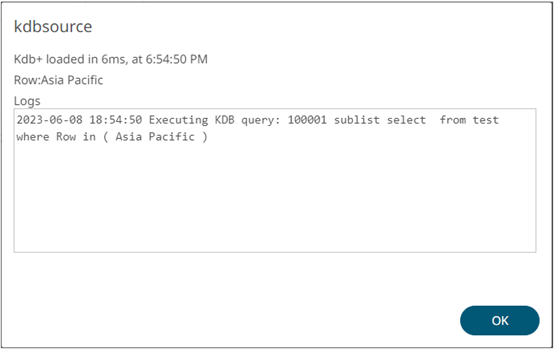

Logs
Logs of the last query.
IMPORTANT: In Panopticon version 2023.0, query logging is only available for the Kx kdb+ connector.

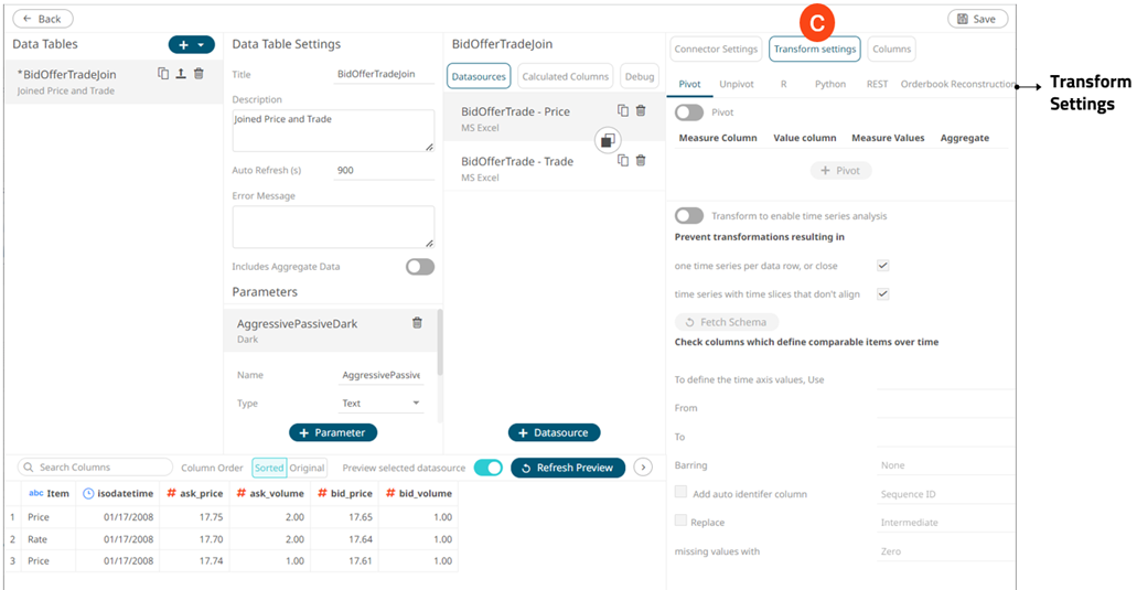

Clicking Transform Settings    displays the Transform Settings pane.
Section
Transform Settings
Allows you to perform the following:
·         Pivoting or unpivoting retrieved data.
·         Transforming data to enable time series analysis including interpolation.
·         Running an R or Python script for data transformation.
·         Lists of orders to be reconstructed into an Order Book and conflated for output display.

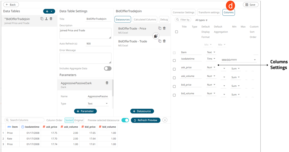

Clicking Columns   displays the Columns Settings pane.
Section
Columns Settings
·         View the column data type
·         Rename the column names
·         Select the numeric or Date/Time format
·         Select the numeric default aggregation
·         Define the Min and Max range of numeric columns
·         Define custom sort order
