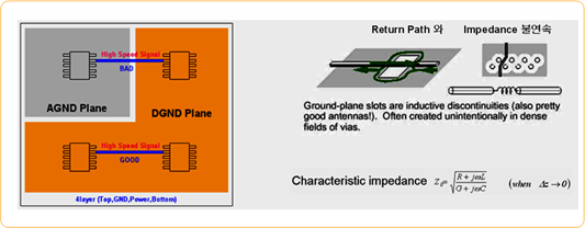

Impedance Mismatching
It will be an ideal condition if impedance at input and output ends are the same. This condition is called impedance matching and output signal can send its signal to input side without any loss.
