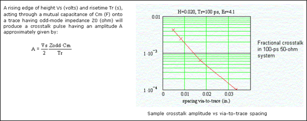

Via-Trace Crosstalk
Inductive coupling is null to zero due to the perpendicular current flows on via and trace.
