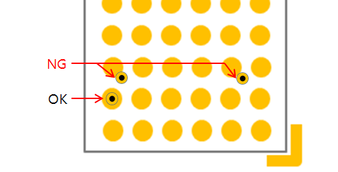

    • Via Location on Pad’s Center: If via placed on pad’s area, they should be placed at same location. Item checks whether they are at same location or not. If their locations are different, it is fail.
      • Item: Specify the item name.
      • Comp Group: Select target components from component group list.
      • Via Type: Select via type.
      • Tolerance: Set tolerance value. Within tolerance, PollEx DFM treats them as same location.

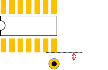

      • Via's on Pad's Symmetry: Check whether the via hole is located on the component pad's central axis (long axis).
