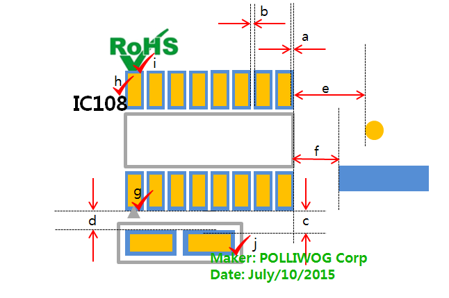

Figure 1.- Clearance between Solder Mask and Pad in Same Component: Set
the clearance value between solder mask and pad.
- Maximum distance between Solder Mask and Pad in same Component: Even if the distance between the pad and solder mask satisfies the upper inspection option Clearance condition, if it exceeds the maximum distance value Fail
- Regard Pad as Pass with having greater than given value for any direction: On the clearance checking between the edges of Pad and Solder Mask, this option is considered to pass if either direction is satisfied.
- Clearance between Solder Masks in Same Component: Set the clearance value between solder mask and solder mask.
- Clearance between Pad and Other Component’s Solder Mask: Set the clearance value between pad and other components’ solder masks.
- Clearance between Solder Mask and Other Component’s Solder Mask: Set the clearance value between solder mask and other component solder masks.
- Clearance between Solder Mask and Board Figure Pads: Set the clearance value for solder mask and board figure type pads.
- Clearance between Solder Mask and Board Figure Solder Masks: Clearance checking between the Solder Masks of Pad and Board Figure.
- Clearance between Solder Mask and other Net: Clearance
checking between the Solder Masks of Pad and Net.
- Recognize as different nets if other nets are connected to the same reference.
- Check exposed copper on the same net due to solder mask.

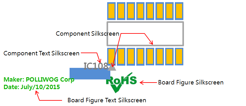

- Solder Mask Overlapping with Component Figure Silkscreen: Option to check the area where the Solder Mask and Component Figure silkscreen overlap. Overlapped area is considered as fail.
- Solder Mask Overlapping with Component Text Silkscreen: Option to check the area where the Solder Mask and Component Text silkscreen overlap. Overlapped area is considered as fail.
- Solder Mask Overlapping with Board Figure Silkscreen: Option to check the area where the Solder Mask and Board Figure silkscreen overlap. Overlapped area is considered as fail.
- Solder Mask Overlapping with Board Figure Text Silkscreen: Option to check the area where the Solder Mask and Board Figure Text silkscreen overlap. Overlapped area is considered as fail.

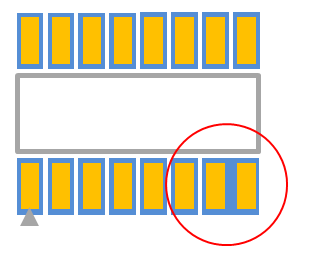

- Check Solder Mask usage in multiple Pins: Check multiple
shares same solder mask.
Figure 2. - Check Solder Mask usage between Pins(Only 2Pin Component): Option to check whether the Solder Mask is filled between the Pads where the component has only 2 pins.

- Overlapping with below Types of Silkscreen: Check silkscreen
data’s overlapping with board figure geometries.
Figure 3.- Component Figure: Option to check whether the Solder Mask and Component Figure silkscreen overlap.
- Component Text: Option to check whether the Solder Mask and Component Text overlap.
- Board Figure: Option to check whether the Solder Mask and Board Figure silkscreen. overlap.
- Board Figure Text: Option to check whether the Solder Mask and Board Figure Text silkscreen overlap.
