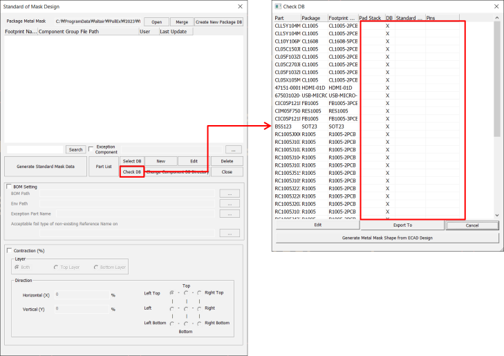

Figure 2. - In the Check DB dialog, click Generate Metal Mask Shape from ECAD Design.
Click
in the Component DB Path category, and set the directory as: C:\ProgramData\altair\PollEx\<version>\Examples\MFG\MetalMaskManager\ComponentDB.
If the folder does not exist, create it first. -
Click Generate.

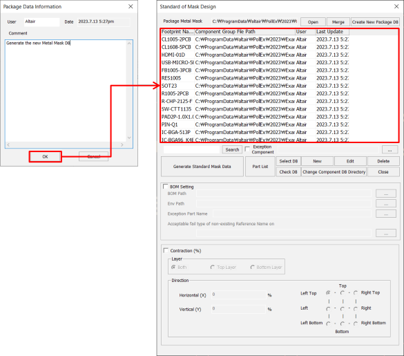

Figure 3. - Enter a comment in the Package Data Information dialog for managing the history of the metal mask DB modification.
- Click OK to register the components in the Package Metal Mask DB (*.mmdb).

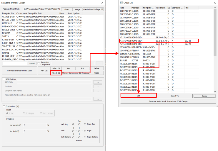

In the Standard of Mask Design dialog, click
Check DB to check that the component DB and
the standard metal mask shape are registered.
For the part name 47151-0001, pins from 20 to 23 are not registered and the corresponding pad stack names are L3.3-1.5_R90_T, and L2.7-1.5_R90_T respectively.

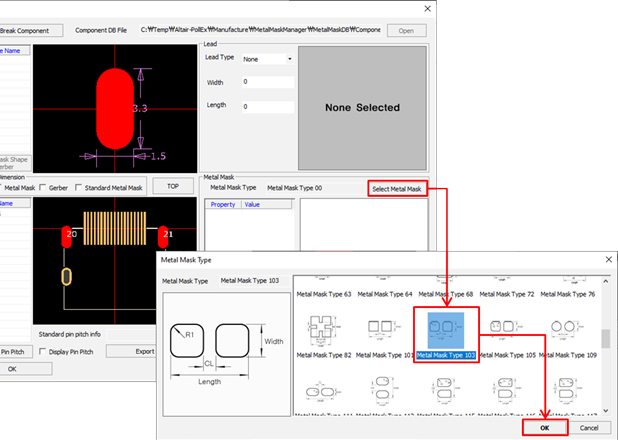

Click Edit to edit the metal mask of the
selected part.

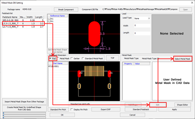

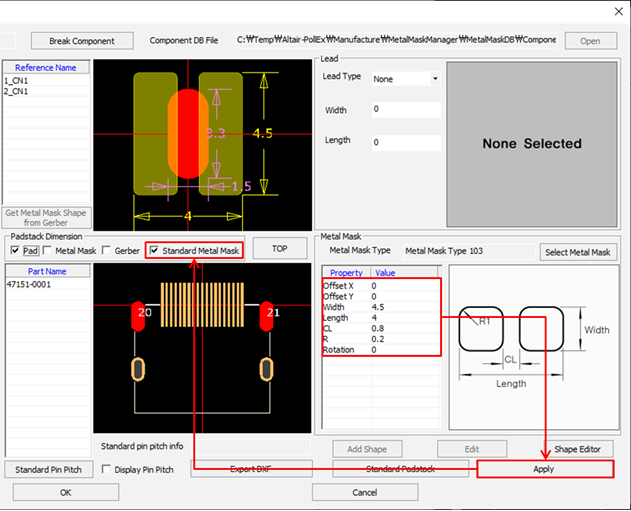

Figure 5. - Select L3.3-1.5_R90_T from the Padstack list.
- Enable the Pad checkbox in the Padstack Dimension section to check the pad size.
- Click Edit.
Click Select Metal Mask.
Figure 6. -
In the Metal Mask Type dialog, select the
Metal Mask Type 103 and click
OK.
Figure 7. -
In the Metal Mask section, enter the following values for the metal
mask size information and click Apply.
- Offset X/Y = 0
- Width = 4.5
- Length = 4
- CL = 0.8
- R = 0.2
- Rotation = 0
Enable the Standard Metal Mask checkbox to check
the size of the created metal mask shape.

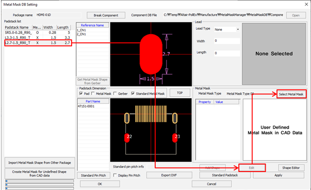

Figure 8. - Select L2.7-1.5_R90_T from the Padstack list.
Click Edit and Select Metal
Mask.
mask size information.
- Offset X/Y = 0
- Width = 3.5
- Length = 4
- CL = 0.8
- R = 0.2
- Rotation = 0
- Click Apply to apply the entered values.
- Click OK to close the Metal Mask DB Setting dialog.
dialog and click OK.
The Modified part is displayed in blue.
- Click Close to close the Standard of Mask Design dialog.

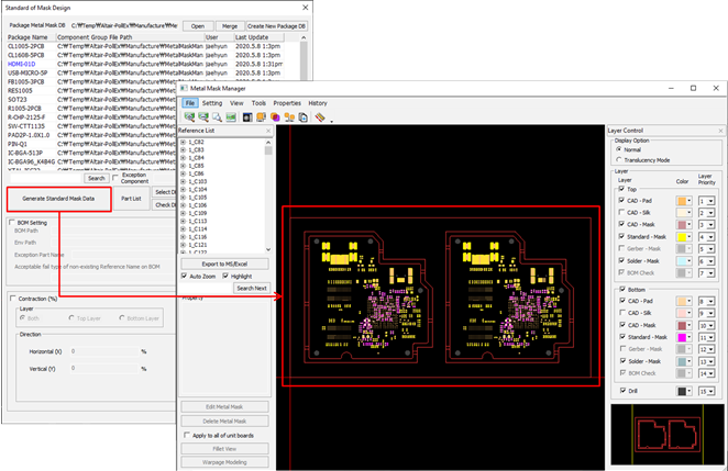

Figure 11.-

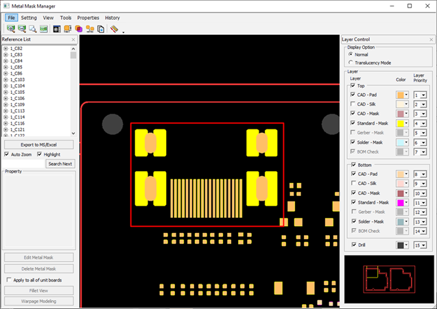

Click Generate Standard Mask Data.
The metal mask shape of each part registered in the Package Metal Mask DB (*.mmdb) is reflected to the design data.
Figure 12. -

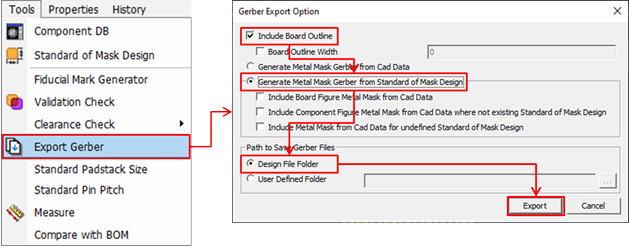

Export to Metal Mask Gerber.
From the menu bar, click Tools > Export Gerber.
Figure 13. - In the Gerber Export Option dialog, enable the Include Board Outline checkbox.
- Select Generate Metal Mask Gerber from Standard of Mask Design.
- Select Design File Folder in the Path to Save Gerber Files section.
- Click Export.
- Review the exported Gerber files in PollEx CAM.
