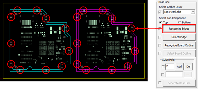

Click Recognize Bridge.
The line corresponding to the bridge is automatically searched. The recognized line of the bridge is displayed in white, and the vacuum hole is in red.
Figure 3. -

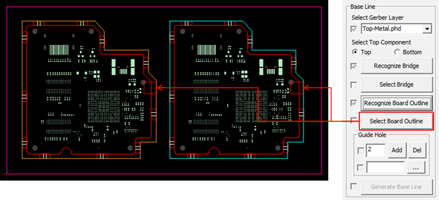

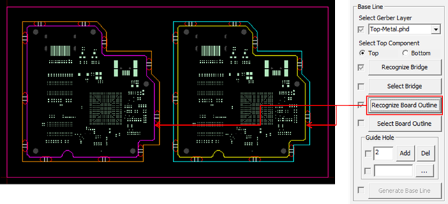

Click Recognize Board Outline.
The board outline is automatically recognized from the Gerber data.
Figure 4. -
Click Select Unit PCB Outline.
The selected unit PCB outline is highlighted in red and is the basis for creating the base line.

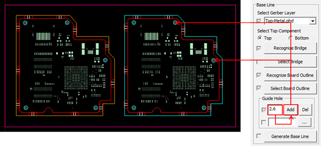

Figure 5. - In the Guide Hole section, enter 2.6 for the diameter and click Add.
- Click the location of the guide holes in the PCB design data.
Repeat steps 5.f - 5.g until all guide holes in the PCB design are
selected.
Figure 6. -

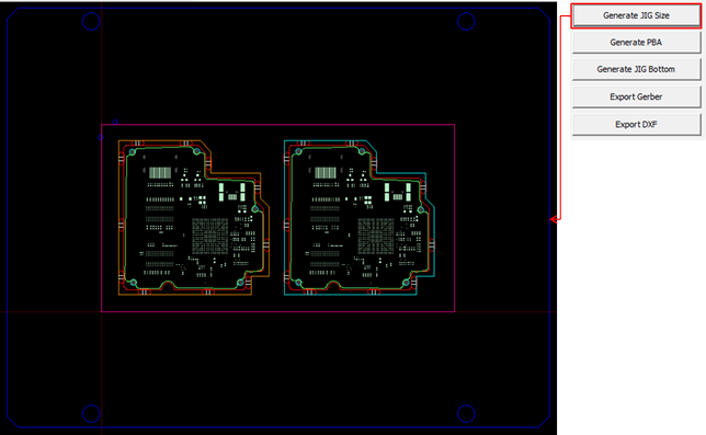

Click Generate JIG Size.
The outline of the router JIG is generated and is displayed in blue.

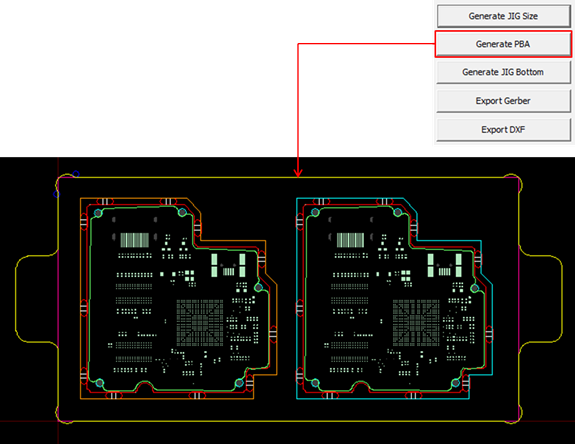

Click Generate PBA.
A processing line for panel PCB mounting on the router JIG which is generated and is displayed in yellow.

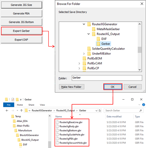

Export JIG Data.
- Click Export Gerber.
Specify the path to save the data and click OK.

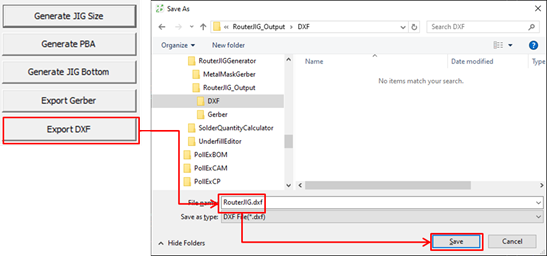

Figure 11. - Click Export DXF.
Save.
