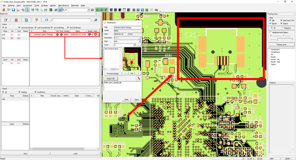

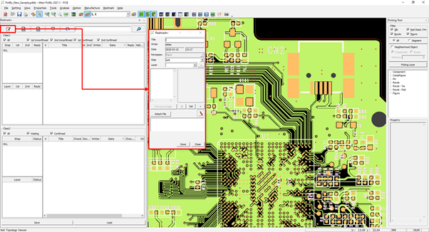

Click .
The creation window opens.
Check created issues.
The created issue is displayed when a Redmark+ Item List is selected. Figure 2.

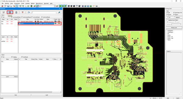

Delete the created issues.
Enable the checkbox of the issue to be deleted and click .
Figure 3.

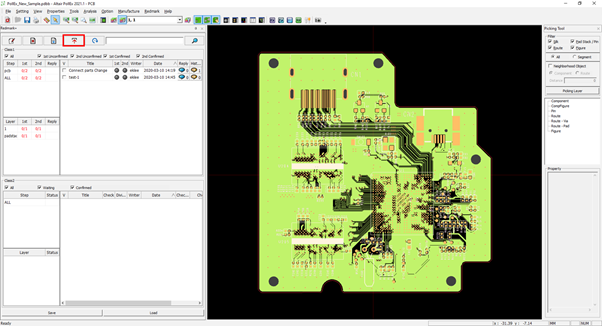

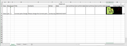

Export the results to Excel file.
Click .

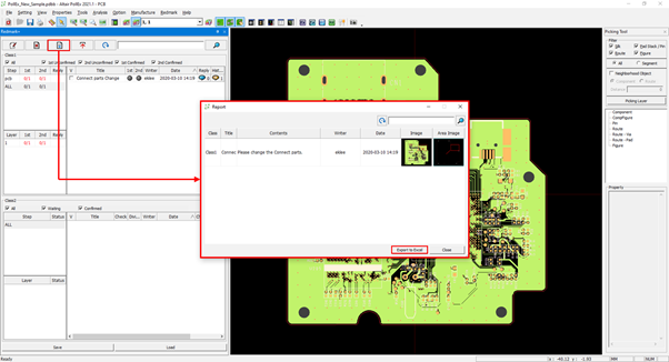

Figure 4.
The list of issues to be reported is displayed.
Click Export to Excel and specify the save
location.
Figure 5.

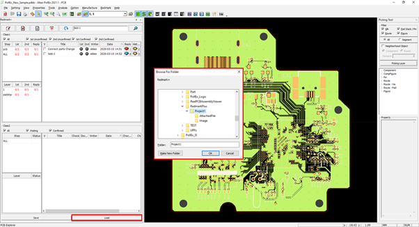

Search and reset.
Enter the title or content in the search bar.
Click to initialize the search history.
Figure 7.

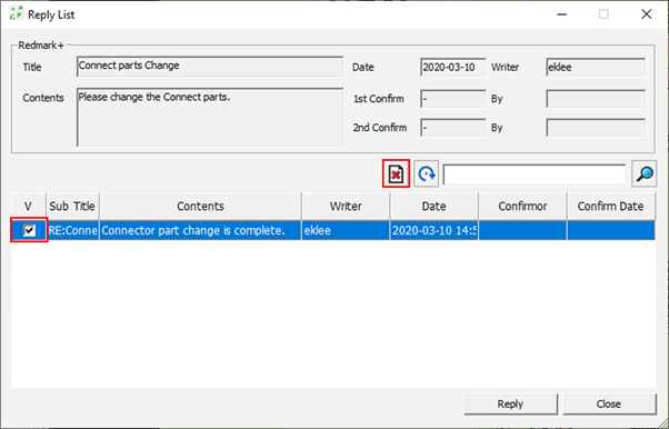

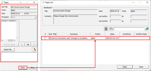

Add comment.
Click to add a comment to the
issue.
The Reply List dialog opens.
After leaving a comment, click Reply.
Add a comment or file attachment.
Figure 8.
Enable the checkbox of the list to be deleted and click .

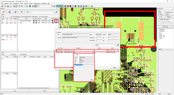

History management.
Click to review the history of each
comment.
Figure 10.

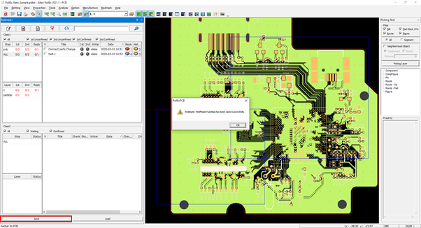

Save and load Redmark+ data.
Click Save to save the file in
*.prmkp format.
Figure 11.
The file is saved in the specified project path.
