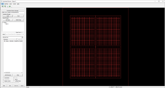

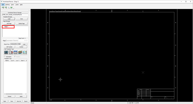

  3. Load Template Format file.
    1. Click Load.
    2. Select the C:\ProgramData\altair\PollEx\<version>\Examples\Modeler\Additive\WorksheetPlanner_Sample.ppwt file and click Open.
      A page is automatically created in the left page list, and a sheet form is displayed on the screen.

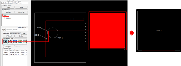

  4. Create Page Template.
    1. Click the in the Add Template Type section.
    2. Click and drag in the right screen to create a Worksheet Planner Sample.
    3. Click the View1 screen.
      The data is displayed on the screen.

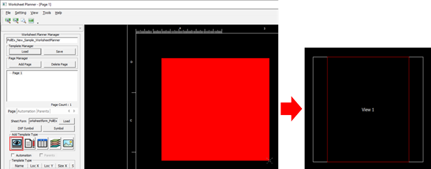

  5. Layer Setting.

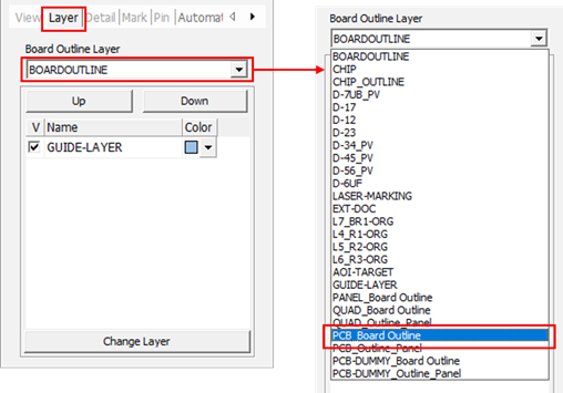

    Set the Layer in the Layer tab.
    1. In the Layer tab, click Change Layer.
      The Select Layer From List dialog opens.
    2. In the Select Layer From List dialog, enable the GUIDE-LAYER checkbox and click OK.
    3. Select PCB_Board Outline from the Board Outline to display the layer on the screen.
    Figure 4.

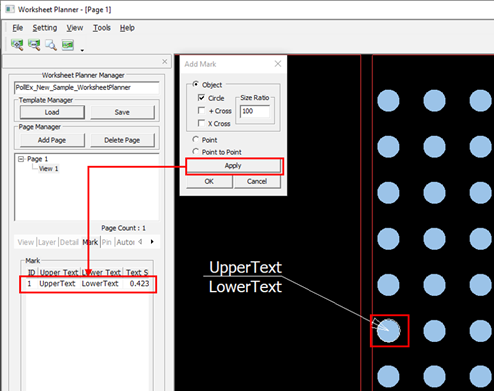

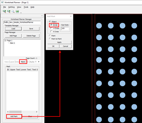

  6. Add Mark.
    1. Click Add Mark in the Mark Tab.
      The Add Mark dialog opens.
    2. In the Add Mark dialog, enable the Circle checkbox.
      Figure 5.
    3. Select the pad on the screen, click Apply, and click OK.
      Figure 6.

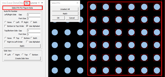

  7. Mark Pin Name.

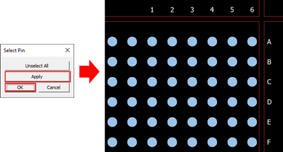

    1. In the Pin tab, click Select Pin For Figure Data.
      The Select Pin dialog opens.
    2. Using the mouse, drag and select the pin area to create a pin number on the right.
      Figure 7.
    3. Click Apply and click OK.
      The Pin Name is displayed on the screen.
      Figure 8.

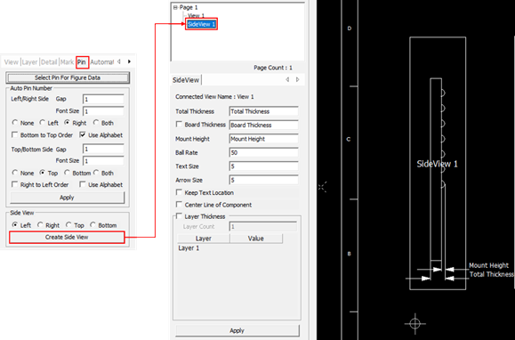

  8. Create Side View.
    1. Click the Create Side View.
      Side View is automatically created in the Page list.
    2. Click Side View in the list.
      Side View is displayed.
    Figure 9.

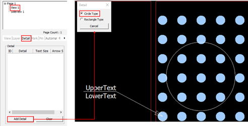

  9. Define details.
    1. Click View 1.

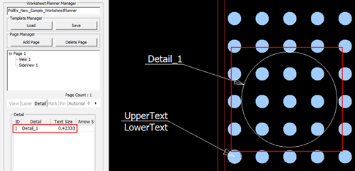

    2. From the Detail tab, click Add Detail.
      The Detail dialog opens.
    3. In the Detail dialog, select Circle Type and set the areas on the screen by dragging the target area.
      Figure 10.
      The detail areas set on the screen are displayed.
      Figure 11.

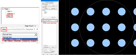

    5. Select View2 and select the View Type detail_1 in the Layer Tab.
      The detail area is displayed on the screen.
      Figure 13.

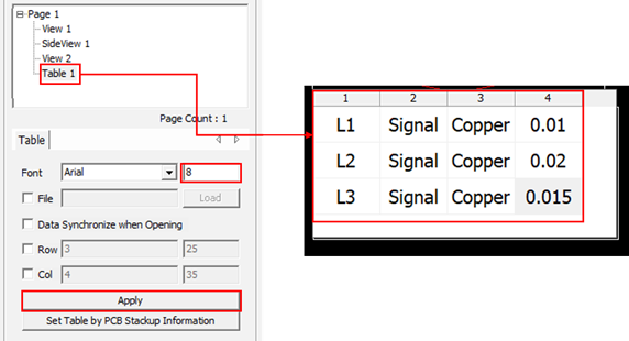

  10. Create table.

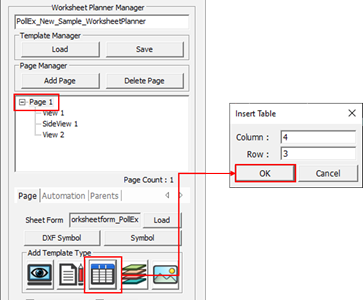

    1. Select Page1 and click .
      The Insert Table dialog opens.
    2. In the Insert Table dialog, set the number of columns and rows to be in the table, and click OK.
      Figure 14.

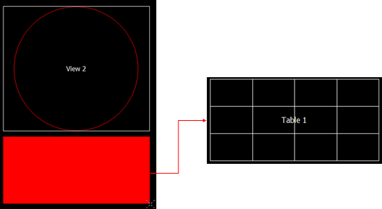

    3. Drag the mouse on the page screen to create a view area.
      Figure 15.
    4. Select a table from the list and enter the stack information in the table.
    5. Change the font size of the entered value and click Apply.
      Figure 16.

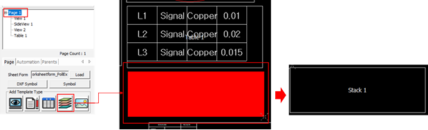

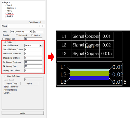

  11. Create Stack.
    1. Select Page 1 and click .
    2. Drag the mouse on the screen to create another view area.
      Figure 17.
    3. Select a stack from the list and set the display value of the stack.
    4. Specify the table to be used for the stack as Table1 and set the stack information. The stack is displayed on the screen.
      Figure 18.

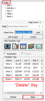

  12. Delete created lists.
    1. Select a list for the templated type list in Page 1, and press Delete.
    2. Click Apply to delete the selected type.
      Figure 19.

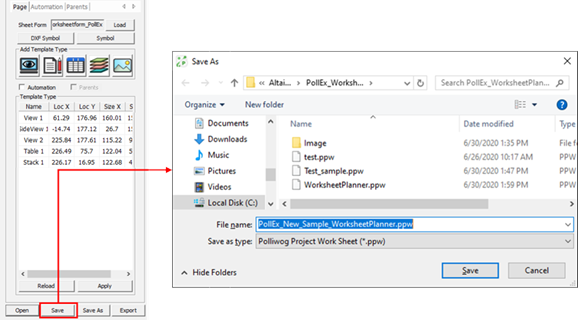

  15. Save and Load Worksheet Planner File.
    When saving, the file name is saved as the sample file name. It is saved in the location where the sample file is located.
    Figure 22.

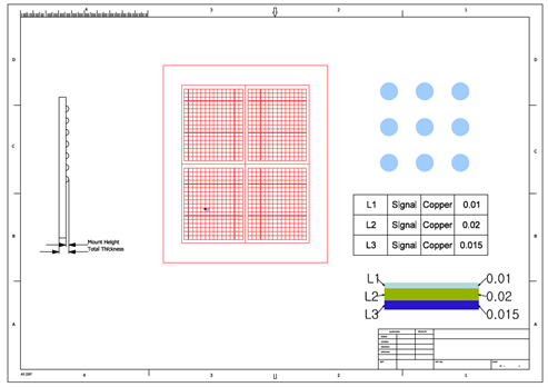

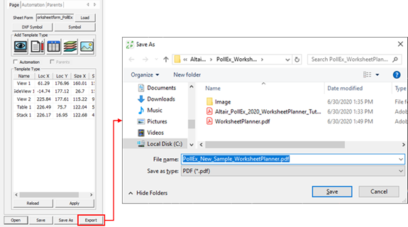

  16. Export Worksheet Planner File.
    You can export the Worksheet Planner file to PDF format.
    Figure 23.
    Figure 24.
