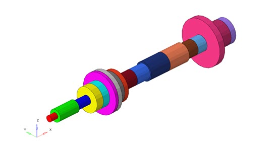

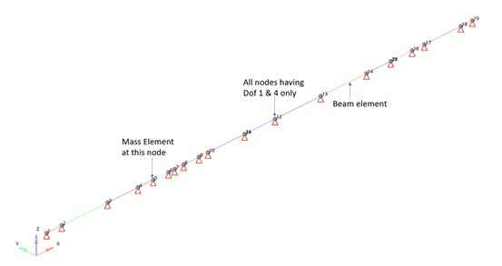

The finite element model, as shown in 図 1 is constrained at all the nodes. Only DOF 1 and 4 are allowed on all the nodes. The model is meshed with beam elements of different sections (図 2). Mass is attached at node 5. An isotropic system is assumed.

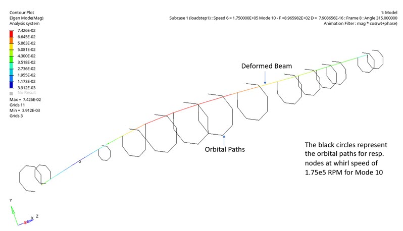

The results are plotted over a range of spin speed for 12 different modes. The deformation of the rotor bearing system can be visualized in HyperView by importing an .h3d file.
図 3. Eigen Mode Contour Plot for Spin Speed of 1.75e5 RPM and 10th Mode

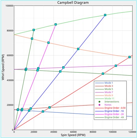

図 4. Campbell Diagram (For Engine Orders 0.5, 1, 2 and 4)

Here, you have verified that the critical speeds obtained by OptiStruct for various whirl ratios are a close match with those mentioned in the Nelson McVaugh Paper.
