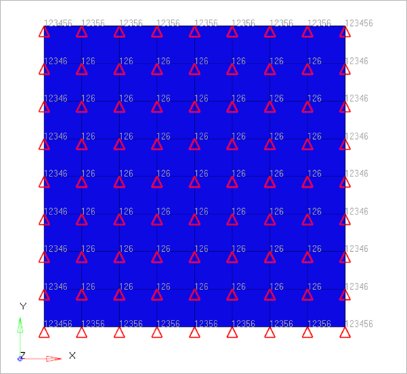

図 1. FE Model with Boundary Conditions and Loadcases

The 2nd order and 1st order quad elements are used to model the square plate of thickness 0.05 m. The z-rotation and x, y translations are fixed for all the nodes, z-translation is fixed along all four edges, x-rotation is fixed along the edge x = 0 and x = 10 and y-rotation is fixed along the edge y = 0 and y = 10.
