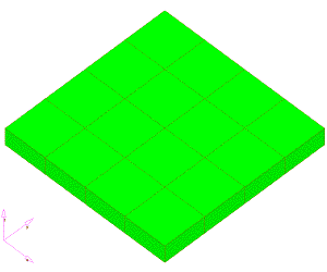

Test No. FV52 A well-established solid square plate, which contains three rigid modes with the given boundary condition. The test examines the performance of OptiStruct Normal Modes Analysis on 3D solid elements.
fv52
図 1. FE Model with Boundary Conditions and Loadcases

The HEXA 8-node and HEXA 20-node solid elements are used in test FV52. An 8x8x3 mesh configuration is used for HEXA 8-node elements, and a 4x4x1 mesh configuration is used with HEXA 20-node elements. The z-directional displacement is constrained at Z = -5 m plane along the four edges of the plate.
