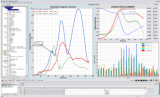

Plots
Plots are essential for obtaining detailed information regarding system behavior as well as for subsequent engineering calculations, such as filtering.
MotionSolve creates the following three file types for plotting:
  1. Altair Binary Format (ABF): This binary file is optimized for fast plotting of very large data sets. This is the recommended format for plotting.
  2. Multibody Results File (MRF): The primary purpose of this binary file is to provide part displacement data to the post-processor module that creates the H3D file used for animation. The H3D file format is discussed later in this document. The MRF file can also be used to create plots. However, the performance may be slower than the ABF file.
  3. Plot File (PLT): This is an ASCII file that can be plotted using HyperGraph. The primary purpose of this file is to facilitate load transfers from MotionSolve to FEA software, such as Nastran and OptiStruct, for durability simulation, using the Load Summary utility available in MotionView.
The MRF and ABF files contain, by default, the displacement time histories of all parts and certain other information as shown in the table below:

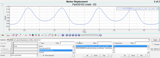

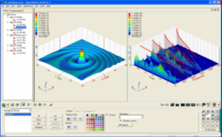

When one of these files is loaded in HyperGraph, the data is automatically organized under three separate categories: Type, Request, and Component. Valid types include Displacement, Velocity, Acceleration, Force and User-Defined. Your model may have one or more requests of each type. All of them are listed under the Request column. When you select a particular request from the list, all available components are displayed in the Component column, as shown in the image below. Please refer to the HyperGraph User's Guide for more details on HyperGraph usage.
An example of organizing plot data into Type, Request and Component categories.

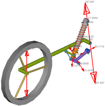

When your model includes a Post_Request element of type MARKER_FORCE asking for one or more forces and moments, MotionSolve automatically writes information to the H3D file that allows you to animate them as vectors as shown in the image below:

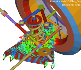

Figure 2. Animating Force Vectors

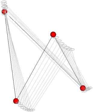

Figure 3. Outline Graphic Connecting Four Spherical Bodies

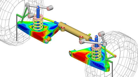

    Figure 4. Result Contours for CMS Flexible Control Arms for a SLA Suspension Model

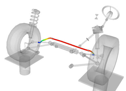

    Figure 5. Result Contours for an NLFE Stabilizer Bar in a Front Suspension Model

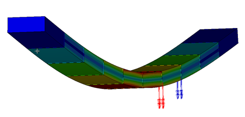

  2. Vector plots
    Figure 6. Displacement Vectors for an NLFE Beam Superimposed on the Stress Contour Plot
    You may create vector plots of the following data types: displacement, velocity (CMS only), acceleration (CMS only), force (CMS only), and moment (torque, CMS only). The vectors may be resolved in a variety of coordinate systems. Scaling and querying are also supported. The vector plots can also be overlaid over the stress contour plots.

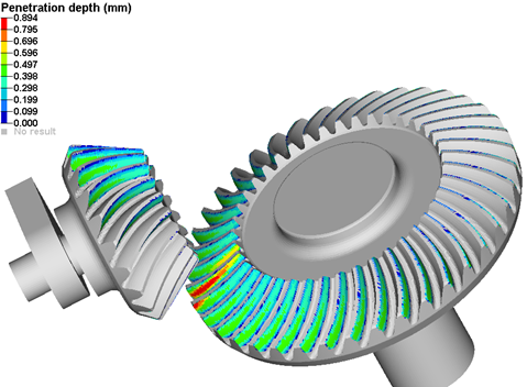

    The contact summary frame is a single frame in HyperView which allows you to visualize the maximum penetrations that occurred in your 3D geometries over the length of the entire simulation. A sample contact summary frame is shown below (in exploded view).
    Figure 8. Contact Summary Frame for Bevel Gears in Contact
    MotionSolve writes an additional load case, called “Contact Overview” to the animation H3D file when the model contains active 3D rigid body contact(s). Within this load case, you can create a contour plot defined by maximum penetration depth.
    The summary frame allows you to quickly check for excessive penetrations in your simulation before animating it. It can also be used to assess whether the areas where contact occurred are as expected. For more information on the contact summary frame, please see the Post-processing section in MV-1010: 3D Mesh-to-Mesh Contact Simulation.

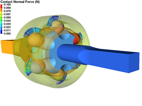

    Figure 10. Normal Contact Force for a Constant Velocity Joint Geometry

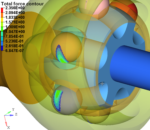

  3. Contour plots:
    You may also use vector plots to display contact forces and velocities. In addition to the total contact force, you can visualize several other results including contact friction force:
    • Contact force (including normal and friction force)
    • Contact velocity (including normal and tangential velocities)
    • Contact penetration depth
    Figure 11. Total Contact Force Contour for a Constant Velocity Joint Geometry

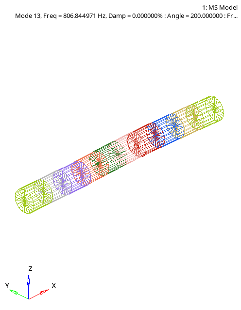

  1. MotionSolve computes and writes the displacements for each mode as transient results from 0 to 360 degrees from complex results in the *..h3d file.

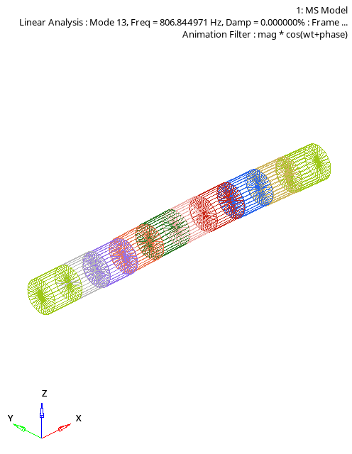

  2. MotionSolve writes the complex nodal displacement to H3D in the _linz.h3d file, and HyperView performs the modal animation.
    Figure 12. Linear results from H3D results
    Figure 13. Linear results from Linz H3D
