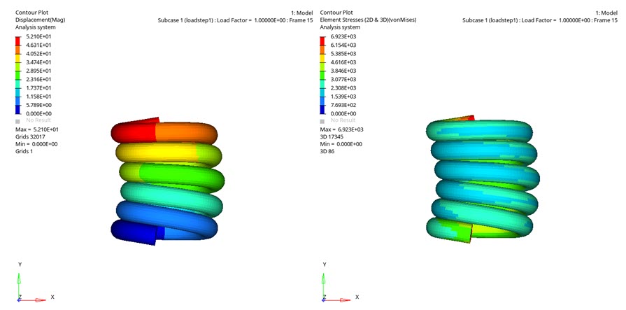

- View the results in HyperView

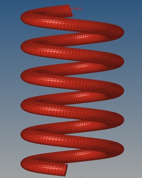

Open the Model
Set Up the Model

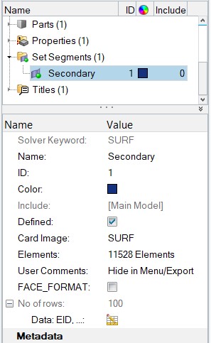

Create Set Segments
The set segments will be defined, which will be used later to define the contact groups.

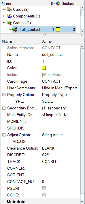

Create Contact Groups
Here the contact groups will be defined.

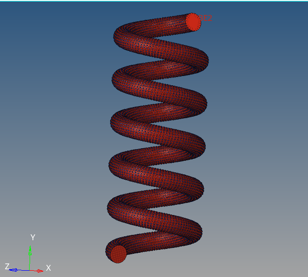

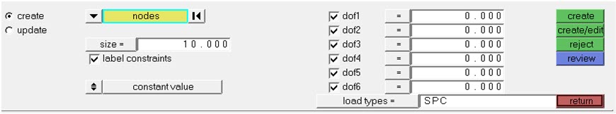

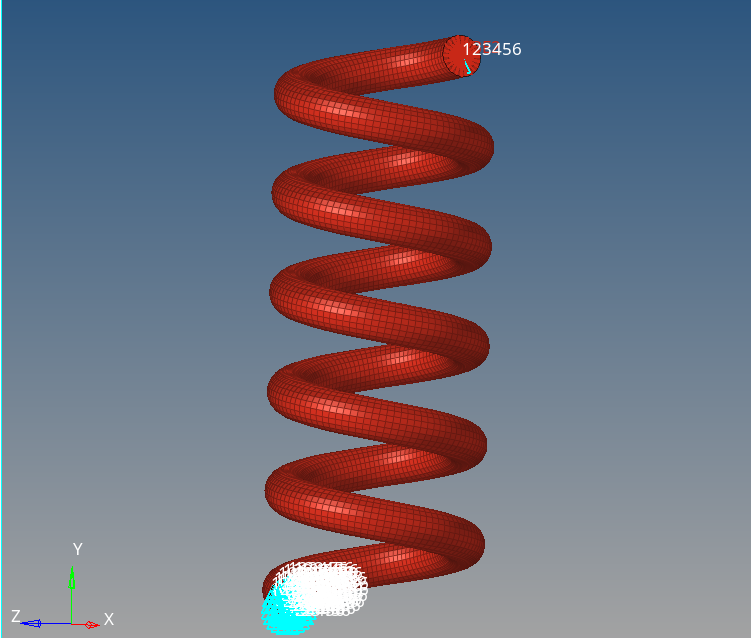

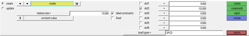

Apply Loads and Boundary Conditions
In the following steps, you will constrain the nodes 36945 and 36946
(Nodes corresponding to RBE2) in all degrees of freedom and a displacement of -52mm
(-ve
for compression) is applied on the node 36945. Other load
collectors required for Nonlinear Analysis are also defined.
Create SPCS Load Collector
Create Displacement Load Collector

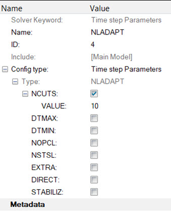

Create NLADAPT Load Step Input

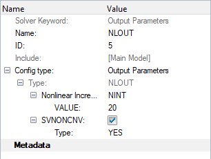

Create NLOUT Load Step Input
