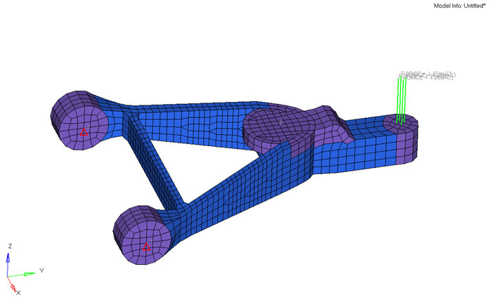

Geometry
Control Arm, sectioned into non-design and designable components.
