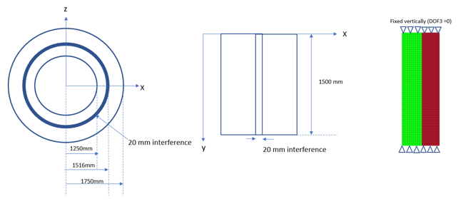

The model examines the contact pressure between two cylinders in case of interference fit of 20 mm.
Figure 1. Model and Loading Description

2D axisymmetric elements (CQAXI) elements are used to model 2 cylinders.
- Material Properties
- Value
- Young's modulus
- 206 GPa
- Poisson's ratio
- 0

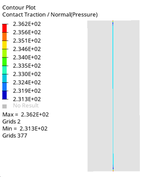

Nonlinear Static Analysis Results
| OptiStruct | NAFEMS | Normalized Target Value | |
| Contact Pressure | 2.35 | 2.27 | 1.035 |
Figure 2. Contact Pressure Between the Cylinders
