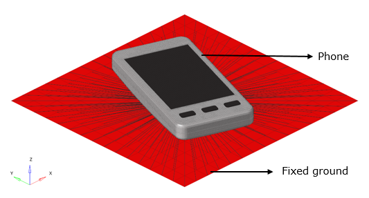

This tutorial demonstrates a phone drop test simulation using Explicit Analysis in OptiStruct when the phone is dropped on the floor with a velocity of 5425 mm/s.

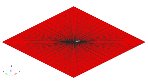

Create SPC Load Collector
In this step, Single Point Constraints (SPCs) is used to fix the floor.

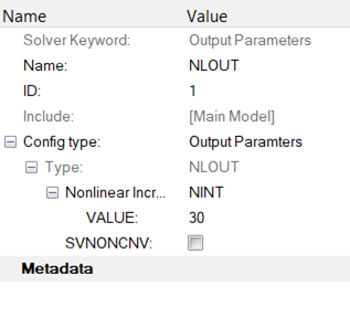

Create NLOUT Load Step Input

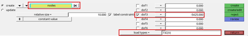

Create INI_VEL Load Collector
In this step, an initial velocity of 5425 mm/s will be applied to the phone in the negative Z direction.

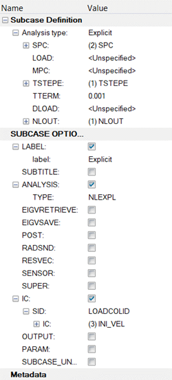

Create Explicit Load Step
In this step, an explicit load step will be created, where the previously defined load collectors and load step input will be referenced.

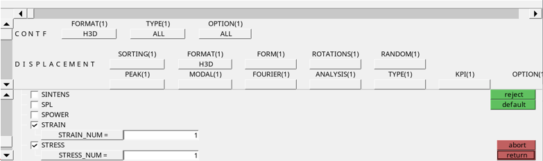

Add Control Cards
In this step, control cards for the simulation will be defined.

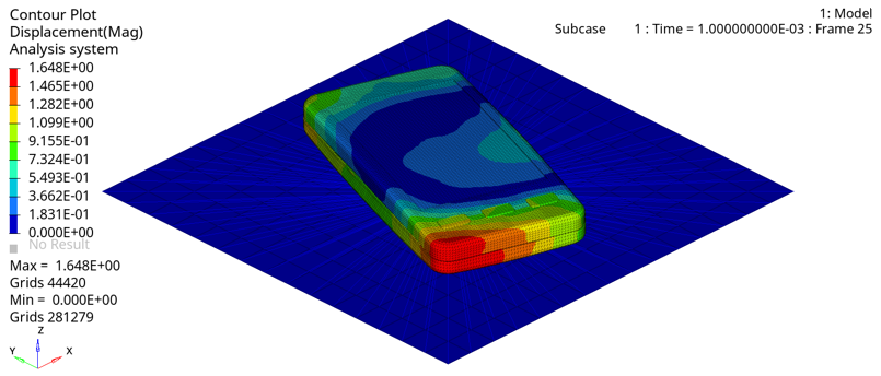

Review the Results
View a contour plot of stresses and displacement.
