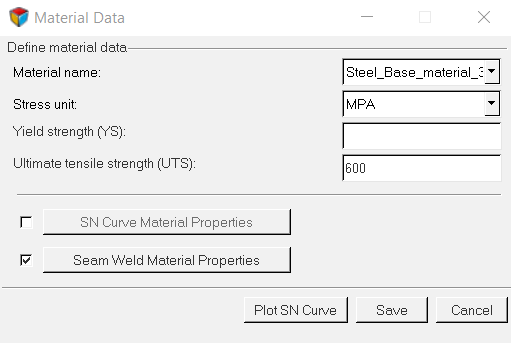

  1. Click Add Material.
    A Material Data window opens.
    Figure 3. Material Data Definition
  2. For Material name, select Steel_Base_material_340Mpa_SAE960X.
  3. Verify that Stress unit is set to MPA.
  4. For UTS, enter 600.

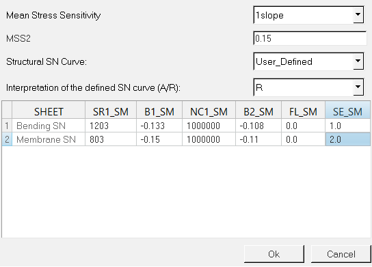

  5. Check box next to Seam Weld Material Properties and then click Seam Weld Material Properties.
    The Seam Weld Material Properties dialog opens.
  6. Enter the values for Mean Stress Sensitivity, MSS2, Structural SN Curve along with bending and membrane SN curve material values, as shown below.
    Figure 4. Seam Weld Material Definition
  7. Click OK to close the Seam Weld Material Properties dialog.
  8. Click Save to save and close the Material Data dialog.

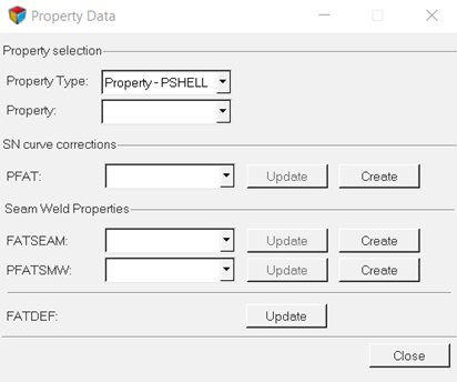

Define Properties
  1. Click Add Property.
    A Property Data window opens.
  2. For Property Type, select Property-PSHELL.
    Figure 5. Fatigue Property Data
  3. Click Close.

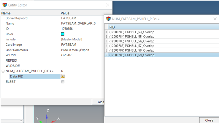

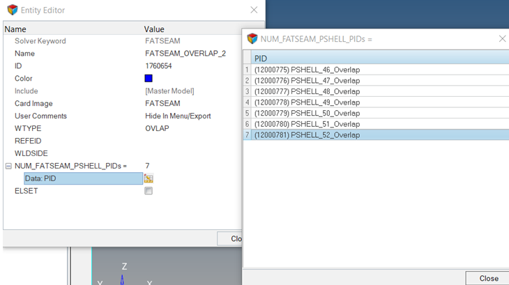

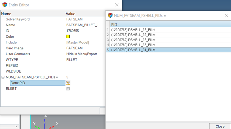

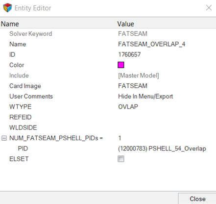

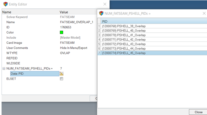

Define FATSEAM Load Collector
FATSEAM helps to select the seam weld type.
In this case it is the fillet weld.
  1. In the Model Browser, right-click and select Create > Load Collector.
  2. For Name, enter FATSEAM_OVRLAP_1.
  3. For Card Image, select FATSEAM.
  4. Set WTYPE to OVLAP.
  5. Set NUM_FATSEAM_PSHELL_PIDS to 7.
  6. Click the table icon next to Data: PID and select 7 different PSHELL IDs for all the 7 PID rows in the table, in the pop-out window.
  7. Click Close twice to close the table dialog, as well as FATSEAM dialog.
  8. Follow the steps above to create 4 more FATSEAM cards, as shown in the images below. The FATSEAM cards can be named as: FATSEAM_OVERLAP_2, FATSEAM_FILLET_1, FATSEAM_OVERLAP_3 and FATSEAM_OVERLAP_4
    Note: Confirm WTYPE is set to FILLET when defining the FATSEAM_FILLET_1 card.
    Figure 6. FATSEAM (FATSEAM_OVERLAP_1) Definition
    Figure 7. FATSEAM (FATSEAM_OVERLAP_2) Definition
    Figure 8. FATSEAM (FATSEAM_FILLET_1) Definition
    Figure 9. FATSEAM (FATSEAM_OVERLAP_3) Definition
    Figure 10. FATSEAM (FATSEAM_OVERLAP_4) Definition
Define PFATSMW Property
  1. In the Model Browser, right-click and select Create > Property.
  2. For Name, enter PFATSMW.
  3. For Card Image, select PFATSMW.
  4. Set BRATIO to 0.6.
  5. Set TREF to 1.1.
  6. Set TREF_N to 0.1.
  7. Click Close.

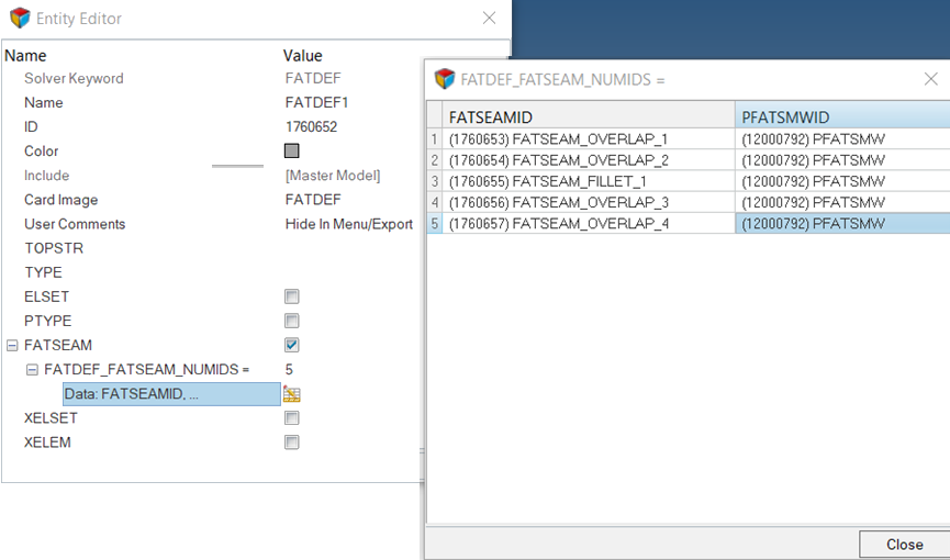

Update FATDEF Cards
  1. Click Update next to FATDEF.
    The FATDEF Entity Editor dialog opens.
  2. Verify that the FATSEAM option is checked and FATDEF_FATSEAM_NUMIDS= field is set to 5.
  3. Click the table icon next to Data: FATSEAMID and from property selector, select the property PFATSMW for all FATSEAMID, as shown below.
    Figure 11. FATDEF Dialog
  4. Click Close to close the FATDEF dialog.
  5. Click Close button to close the Property Data dialog.

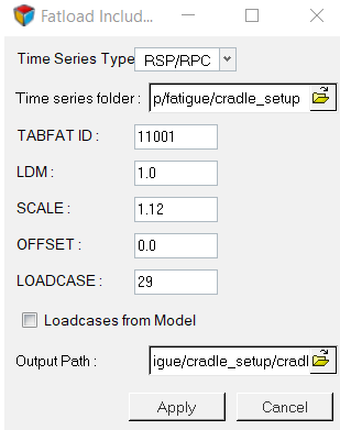

Load Time History Definition
Make sure the task Load-Time History is selected in the Fatigue Analysis tree.
  1. Toggle check box next to Read RPC & DAC files using ASSIGN.
  2. Click Read RPC & DAC files using ASSIGN.
    A dialog pops up.
  3. For Time series folder, select the directory where the RPC files are located.
  4. Enter the values, as shown below.
    Figure 12. Read RPC using ASSIGN Card Dialog
  5. Click Apply.
    This creates two include files (one with ASSIGN cards and the other with FATLOAD and FATEVENT cards) in the output folder for all the channels in all RPC files in the selected Time series input folder.

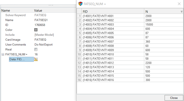

Define FATSEQ Load Collector
It is required to update the FATSEQ card with number of repetitions (N#) for each fatigue event created.
To update the N field of FATSEQ solver card, you can either:
  • Open the exported Solver deck in a text editor, or
  • Import it back into HyperMesh
    When updating the FATSEQ card in an HyperMesh session, follow the below steps.
  1. In a new session, import the OptiStruct Solver deck (exported in previous step) by selecting Include files set to “Merge”.
  2. In the Model Browser, expand Load Collector and select the FATSEQ1 card.
    The Entity Editor opens.
  3. Click the table icon next to Data: FID and enter appropriate Repeat value N for all fatigue events, as shown below.
    Figure 13. FATSEQ Card Update Dialog

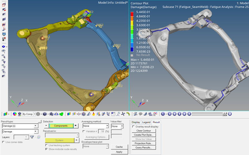

Post-Process
Once the job is completed successfully, check the directory to make sure the .out and .h3d files are available.
  1. Load the results file (.h3d) into HyperView to post-process.
  2. Select Subcase 71 (Fatigue_SeamWeld) from the subcase dropdown.
  3. Go to the Contour panel and select Damage result type.
  4. Click Apply.
    Figure 14. Damage Contour in HyperView
