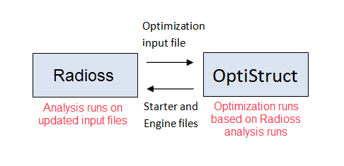

- The optimization process is then continued (using the ESLM method) on the updated results from the Radioss analysis and new optimized design variables are generated. Step 3 to Step 6 are repeated to verify if the process converges after the subsequent iteration. If convergence is achieved, go to Step 8.
- The process ends and
optimized results are output. Figure 2. Optimization Sequence in Radioss and OptiStruct
