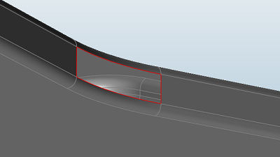

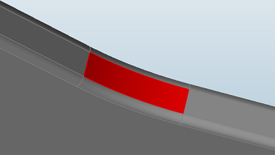

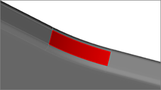

Patch Examples
Example 1: Patch Hole - Before |
Example 1: Patch Hole - After |
Example 2: Patch Between Edges -Before |
Example 2: Patch Between Edges - After |
Example 3: Patch Between Lines -Before |
Example 3: Patch Between Lines - After |
