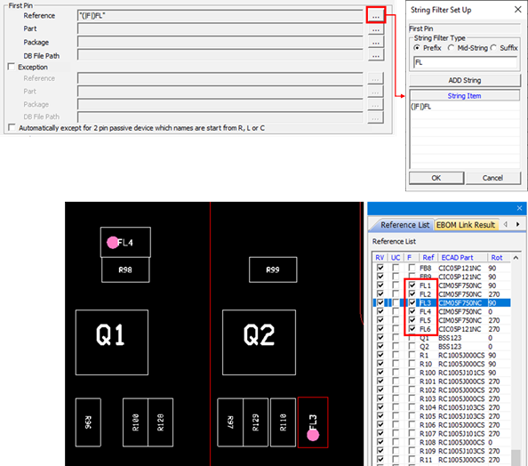

First Pin: Set whether to display the first pin and set the parts to display in
the string filter dialog based on the reference, part, and package names.
For example, when selecting the Prefix and entering FL in the string filter dialog, all first pins of the reference name starting with the string FL are selected in the reference list.
Figure 1.- Exception: Select a part that excludes the first pin marking.
