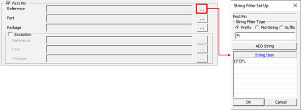

First Pin: Display the polarity mark by designating the part that shows the
polarity at the first pin.
You can set the parts to display in the string filter dialog based on the reference, part and package names. When entering FL after selecting Prefix in the String Filter Set Up dialog, the polarity mark displays at the first pin of the reference name that starts with FL (case insensitive).
Figure 1. -
