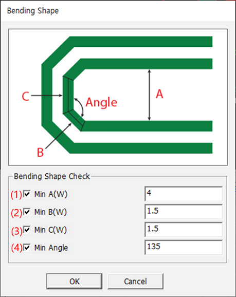

- Bending Shape Check
Figure 1. - Min A(W): Required minimum separation between bending trace.
- Min B(W): Allowable maximum length of segment “B”.
- Min C(W): Allowable maximum length of segment “C”.
- Min Angle: Required minimum trace angle.

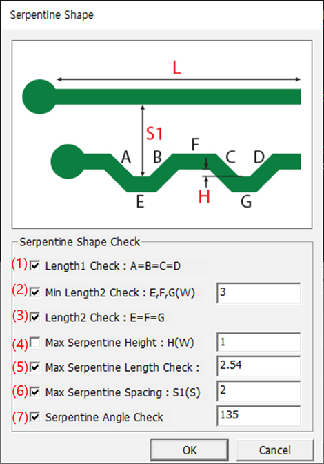

- Serpentine Shape Check
Figure 2. - Length1 Check A = B = C = D: Allowable maximum length of segment A, B, C, D.
- Min Length2 Check: E, F, G (W): Allowable minimum length of E, F, G.
- Length2 Check: E = F = G: Allowable maximum length of segment E, F, G.
- Max Serpentine Height: H (W): Allowable maximum height of serpentine trace.
- Max Serpentine Length Check: Allowable maximum length of total serpentine.
- Max Serpentine Spacing: S1(S): Allowable maximum separation of serpentine.
- Serpentine Angle Check: Required minimum trace angle.
