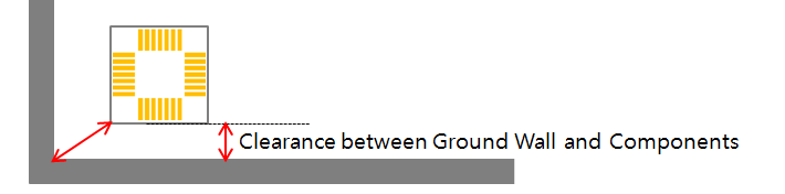

- Clearance between Ground Wall and Component: Check the clearance
between ground wall and components.
Figure 1. Clearance between Ground Wall Corner and Components- Item: Specify the item name.

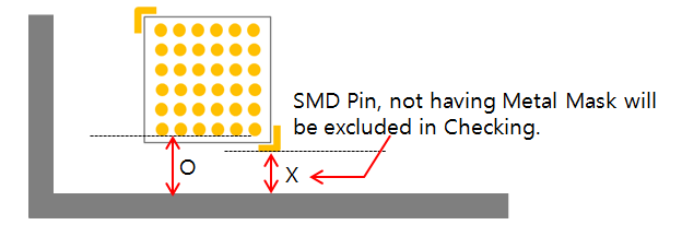

- Void-Checking Component Group: Set void-checking components among specifying components in table.
- Exclude Checking for SMD Pins, not having Metal Mask: Define
additional void-checking component SMD pins.
