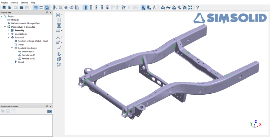

Open Project
  1. Start a new SimSolid session.
  2. On the main window toolbar, click Open Project .
  3. In the Open project file dialog, choose SeamWeld_reactions_Post-processing.ssp
  4. Click OK.
Review Model
  1. Right-click on the Assembly in the Project Tree and select Info to review the model information. This includes number of parts, number of seam welds, and other key parameters.
  2. Close the Assembly Info dialog and expand the Structural subcase available in the Project Tree. Review the loads and boundary conditions created. Note that the model is solved.

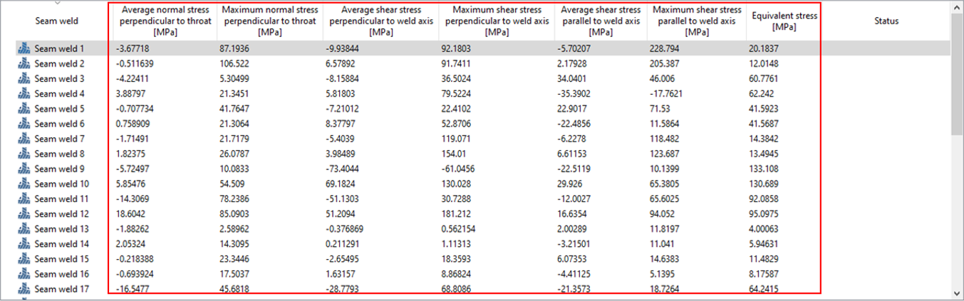

Evaluate Seam Weld Reaction for Stresses
  1. In the Analysis Workbench, click and select Seam weld reactions.
  2. In the dialog, select the Stresses tab.
  3. In the dialog, click Evaluate to calculate the parameters for each of the weld reaction stresses.
    The corresponding values were evaluated for each of the seam welds as shown in the below image.
    Figure 5.
  4. Optional: In the dialog, enable the Include weld section stresses, and then set Section length to throat thickness ratio to 6.0. This evaluates the seam weld reaction for stresses based on the ratio.

Validate Seam Weld Reactions for Stresses
  1. In the dialog, select the Stresses tab.
  2. Enter the value for any of the available criteria as a combination or individually (Normal stress, Shear stress, or Equivalent stress), and then click Validate.
    The welds which are not within the threshold limit show their status as failed (highlighted in red).

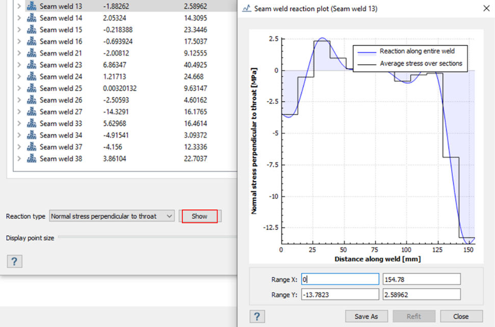

Plot Reactions versus Weld Distance [mm]
  1. From the seam weld list, select any weld.
  2. In the dialog, select a reaction type, and then click Show.
  3. Click Show.
    A plot along the distance of the weld versus the selected reaction type will be generated as shown below.
    Figure 10.
    Note: The same can be some for seam weld reactions evaluated for Force/moment or Stresses.
  4. Optional: The graph can be saved in .png, .bmp, .pdf, or .txt.
