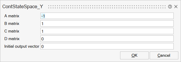

This block implements a continuous-time, linear, state-space system specified by the A, B, C, D matrices. The state vector is computed in such a way that the requested initial output is obtained at the initial time.
Activate/AdvancedDynamical
A | A matrix | real nxn matrix where n is the number of states, default value: 1. | Matrix | |
B | B matrix | real nxm matrix where n is the number of states and m is the number of inputs, default value: 1. B=[ ] if block has no input. | Matrix | |
C | C matrix | real rxn matrix, default value: 1. r is the number of outputs and n is the number of states. | Matrix | |
D | D matrix | real rxm matrix where r is the number of outputs and m is the number of inputs, default value: 1. | Matrix | |
y0 | Initial output vector | vector of size r. | Vector |
