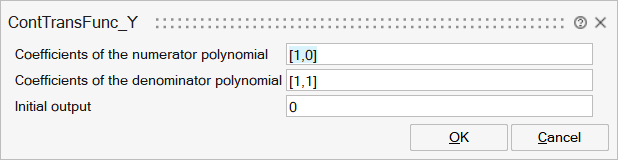

This block implements a SIMO (continuous-time, single-input, multi-output) linear system that is defined by the linear system's transfer function. The transfer function, specified by the coefficients of the function's numerator and denominator, must be proper, meaning that the degree of the numerator must not exceed that of the denominator. The internal state of the block is initialized so that the initial output corresponds to the specified value.
Activate/AdvancedDynamical
num | Coefficients of the numerator polynomial | An mxn matrix where m is the size of the output, and n is the order of the numerator polynomial. | Matrix | |
den | Coefficients of the denominator polynomial | Defines the denominator of the transfer function. | Vector | |
y0 | Initial output | Vector |
Port 1 | explicit | output | 1 | |
Port 2 | explicit | input | 1 |
