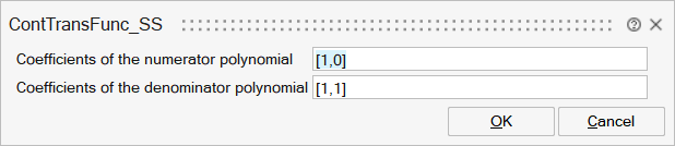

num | Coefficients of the numerator polynomial | A mxn matrix, m is the number of output, n is the order of the numerator polynomial. This must be a polynomial in s domain. | Matrix | |
den | Coefficients of the denominator polynomial | Defines the denominator of the transfer function. | Vector |
