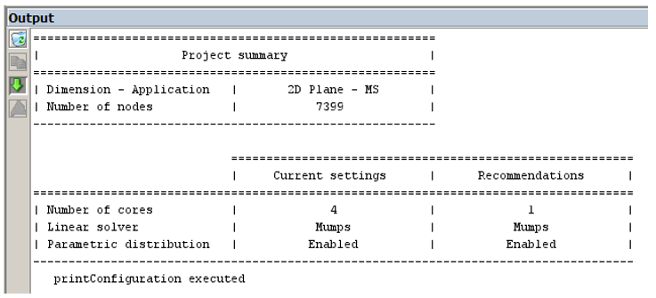

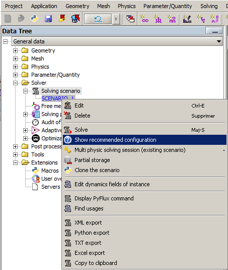

To help you, you can use the recommended configurations given by Flux. There are displayed when you create a new scenario, when you click on Show recommended configuration for a Scenario, or you check the physic. They give you recommendations for the number of cores, the linear solver and if the Parametric distribution is enabled or not in the scenario selected.
