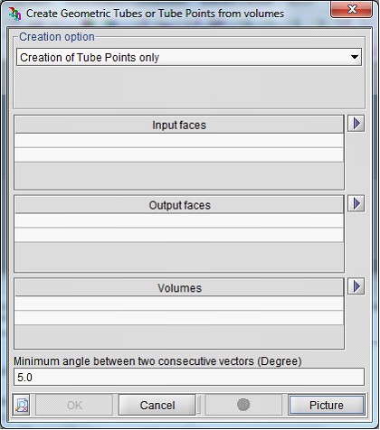

Before being able to execute the algorithm, the user must complete the dialog box presented in the previous map:
In particular, the user:
- must select the input and output faces that define the track of the direction vector
 - must select the list of volumes that the algorithm will take into consideration
 - can modify the minimal value of the angle between two consecutive orientations of the direction vector, expressed in degrees. This field permits to the user to adjust the accuracy of the approximation.

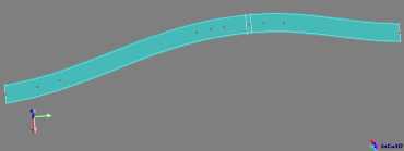

The image below shows the result obtained on the volume in turquoise representing a wire bonding:
Ten Tube Points in red are created in order to approximate the volume: they are more concentrated in the zones of direction changes, while they are more rare in the rectilinear parts.
