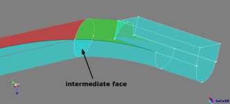

Geometries with strong tangential effects
The geometries representing the cables or the wire bondings can have faces with strong tangential effects, which mean faces where the angle formed by two consecutive sides is very small and the length of these sides is very high. An example is reported in the image below, where the two lines in black represent an angle with a strong tangential effect for the face in red.
The solution to avoid this effect consists in cutting the initial object into several volumes, thus reducing the surface of the face impacted by the strong tangential effect. The user is invited to perform this operation in the context of the CAD import, in order to lean on a cut plane.
The obtained result is shown in the figure below, where the two faces in red and in green have resulted from the cutting of the initial face. The intermediate face, indicated by the arrow, permits the creation of two distinct volumes:

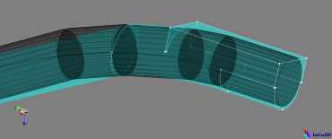

By launching the algorithm in two stages, one for each of the two volumes thus obtained, the Geometric Tubes marked in black in the image below are created to approximate the wire bonding.
