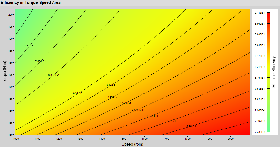

Once the test running is completed, performance maps are displayed in the central area. The filters on the left allow to display directly the performance map wished. The user has the possibility to use a cursor to display values by pointing on the map.

Efficiency map manipulations

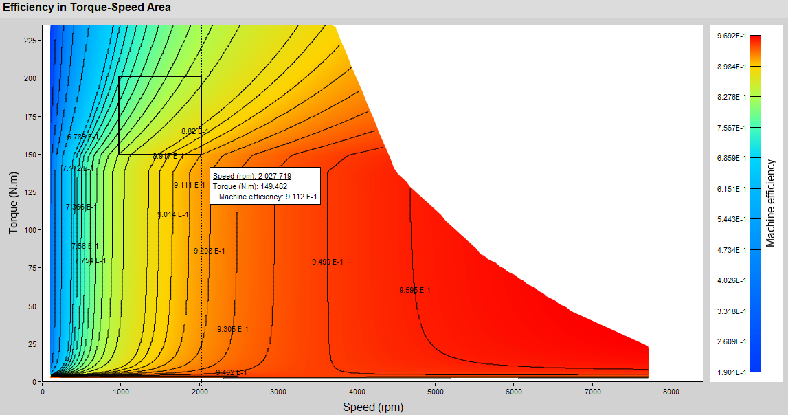

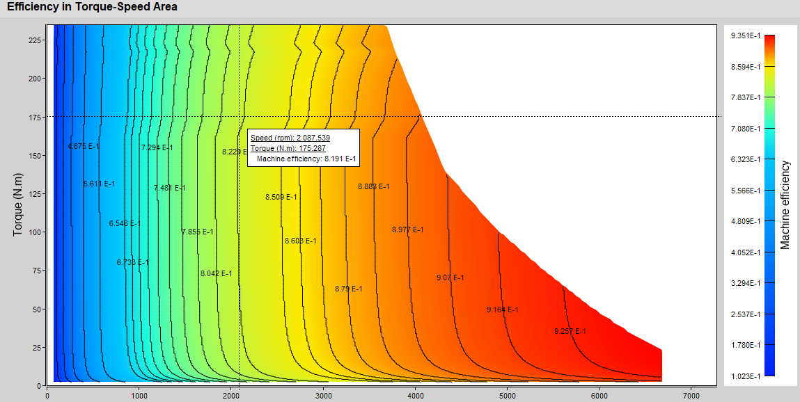

Cursor
The user can display efficiency map values at the cursor position.

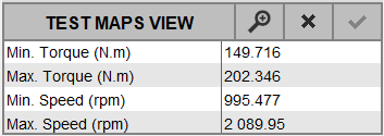

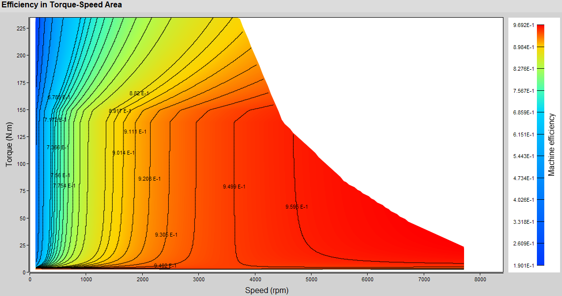

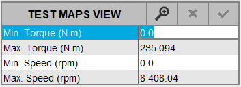

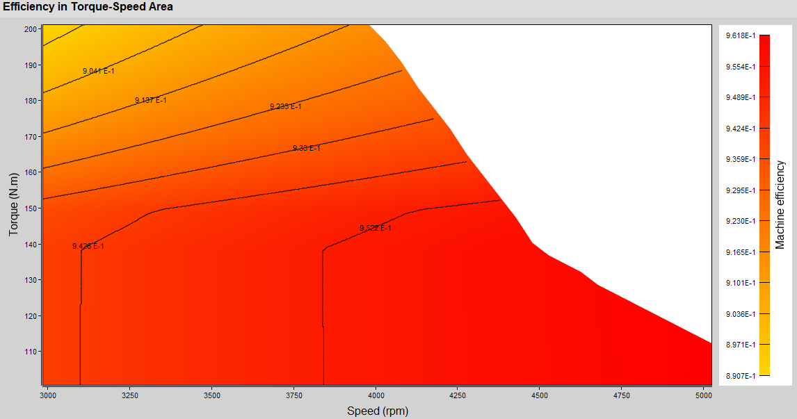

Scale modification
It is possible to modify the scales of all efficiency maps:
- graphically
- manually
- Click on
- On the efficiency map, do a rectangle selection
→ Map rebuilding takes a few seconds
→ Recomputed efficiency maps are updated
Before modification After modification → Values are updated

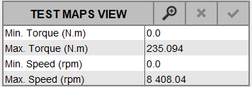

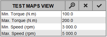

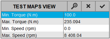

Steps for manual modification of scales
- Edit the value you want to modify
Modify the wished value and validate with the Enter key
Edit and Modify other values if you want
Validate all modifications by clicking on

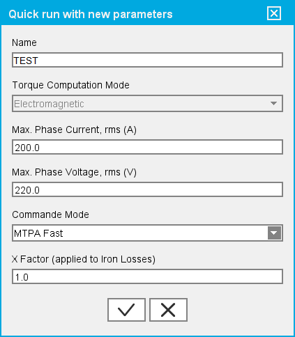

Quick run with new parameters
It's possible to create and run a new test with new values of some parameters. The possible parameters to modify are the parameters which no need a re-solving of the Flux project, but only a re-compute and re-display of maps.
The possible parameters to modify for a quick run are:
- Torque Computation Mode
- Max. Phase Current, rms (A)
- Max. Phase Voltage, rms (V)
- Command Mode (MTPA/MTPV or MTPA Fast/MTPV Fast)
- X Factor (applied to Iron Losses)
The maps will be updated in only few seconds.

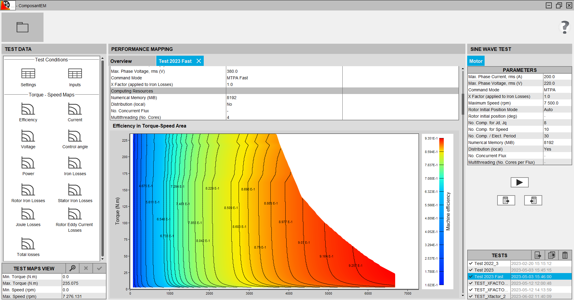

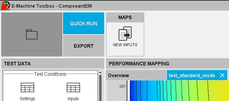

- Open the Quick run with new parameters dialog box:
Display the
wished test by double click on it.
→ the test are displayed on the center area in a new tab
→ The ribbon with Quick Run button appears
Note: It's also possible to open the Quick run dialog box:- by selecting the test in the list and by clicking on
- or by a right-click on the test and by selecting in the contextual menu → Quick run
→ the dialog is opened
- Fill the fields with the new customs values and validate
→ a new test is automatically created in the TESTS table and the maps are generated in few seconds

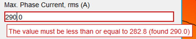

- Imax is the initial value of the “Max. Phase Current, rms (A)”. It will always be the value of the original fully computed test, even if the test is post-processed from another post-processed test.
- Then ImaxNew should be 0.5*Imax ≤ IMaxNew ≤ Imax otherwise
extrapolation may cause accuracy loss. A warning message is displayed in
that case.
- ImaxNew < √2*Imax otherwise an error message will be
displayed
