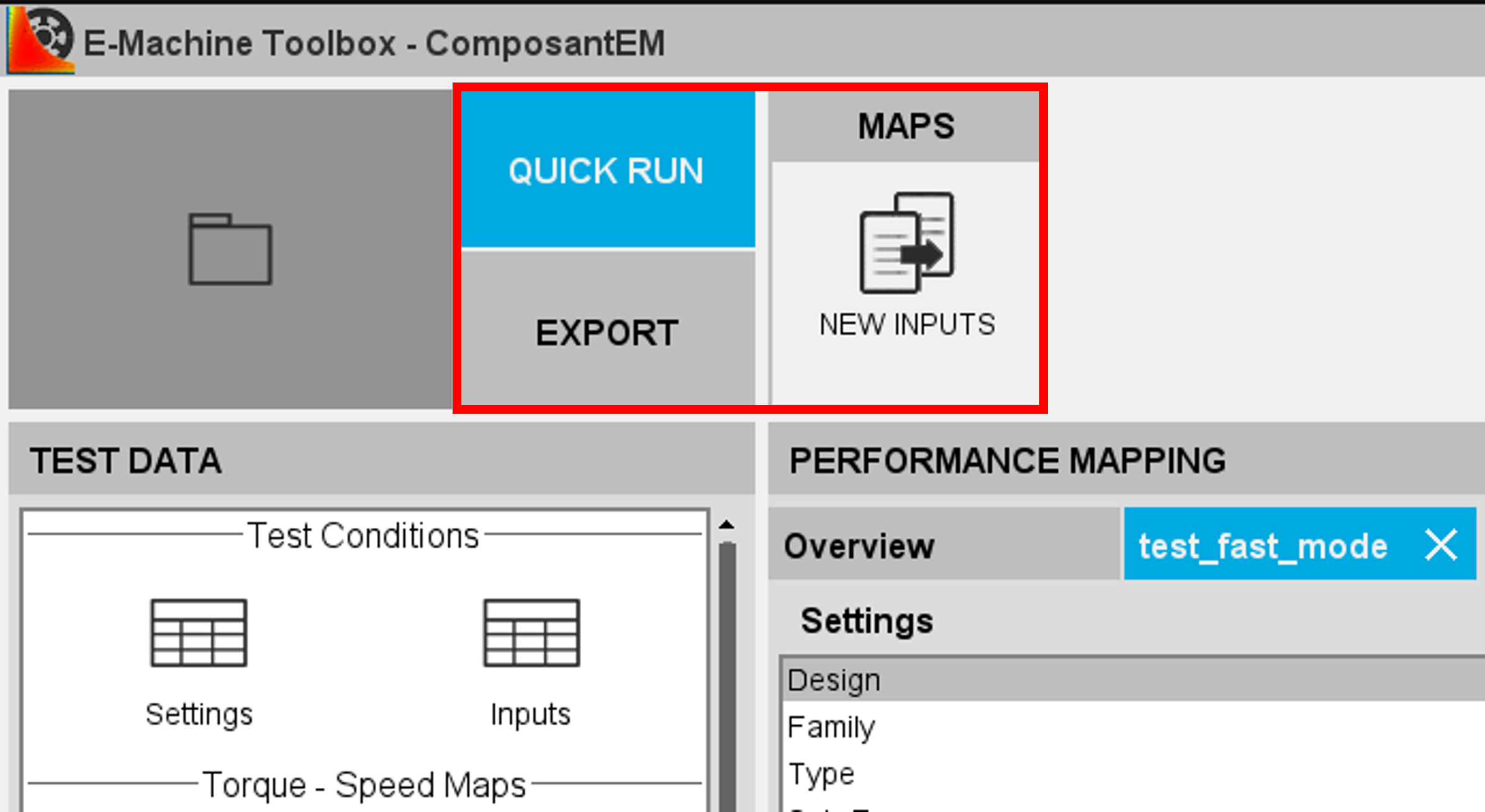

run a test in FeMT by clicking on

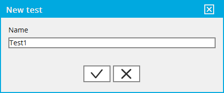

A dialog box appears in which the user must choose the name of the test and click on

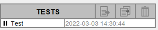

Once the test running is done, the test appears at the bottom right. Several tests can be run on a same component, in this case they are listed:

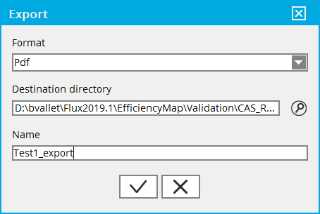

Export a test:
by selecting it from the list and choosing the post-process from the functions in the ribbon bar above.
- or by selecting it in the list and by clicking on
- or by a right-click on it and by selecting ni the contextual menu→ Export
by selecting the test from the list and choosing the desired export from the functions in the ribbon bar above.
or by a right-click → Quick Run

A test can have 4 states:
: the test is successful
: the test is in progress
: the test was failed or was interrupted during the Flux computation and this test is potentially resumable
: the test is failed and it's impossible to resume the computation
Export a test
A test can be exported in 3 different formats:
- pdf format for a report (equivalent to all the content of the central area)
- html format for a report (equivalent to all the content of the central area)
- txt format to post-process data (a text file by quantity)
- mat format to export Lookup tables for PSIM or Altair

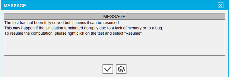

During Altair Flux e-Machine Toolbox computations, it happens that Flux fails (for example because of a lack of memory). In some cases we are able to resume it.
A test is resumable if a crash of Flux happens during the solving stage:
When a test fails and is resumable, a new error dialog is displayed, explaining that is possible to resume this test.
A failed test during Flux computations is identified with the icon if it is
resumable.
To try to resume the test right-click on the test and choose Resume:
After clicking on “Resume” menu item, computations will restart from the last solved step.
