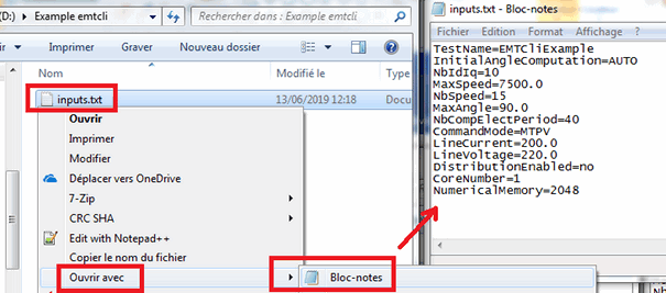

- In a user working directory, create a new text file named « inputs.txt »
- Open the « inputs.txt » file in a text editor and enter wished values for
input parameters of test to run:

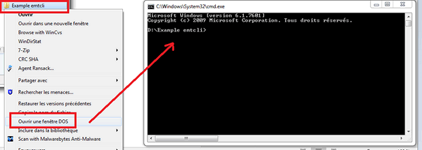

- From a Windows Explorer, open a DOS window in the working directory
