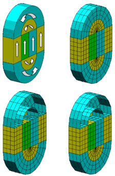

Let us consider device below which consists of eight volumes, meshed by extrusion (extrusion by translation for the first four volumes and extrusion by rotation for the other four volumes).
Two different extrusive meshes have been carried out, one with a triangular base, the other with a rectangular base.
On these meshes, one can notice :
- the capacity to mesh while forming a cycle.
 - an extrusive mesh in rotation with specific elements near the axis (prisms, tetrahedrons, pyramids).
 - the direction of extrusion of low importance
