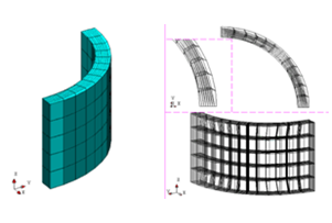

                     The mesh of the first tile is not perfect, but the deformation of the elements stays within acceptable limits, so the mesh is correct. |
                     The second tile is thinner. It has a thinner mesh across the volume. The elements are very distorted and most of the elements that touch the internal face are not correct. To obtain a correct hexahedral mesh, one can either sub-cut the volume, or, (preferable for this geometry), use an extrusive geometric mesh generator with a mapped base. |
