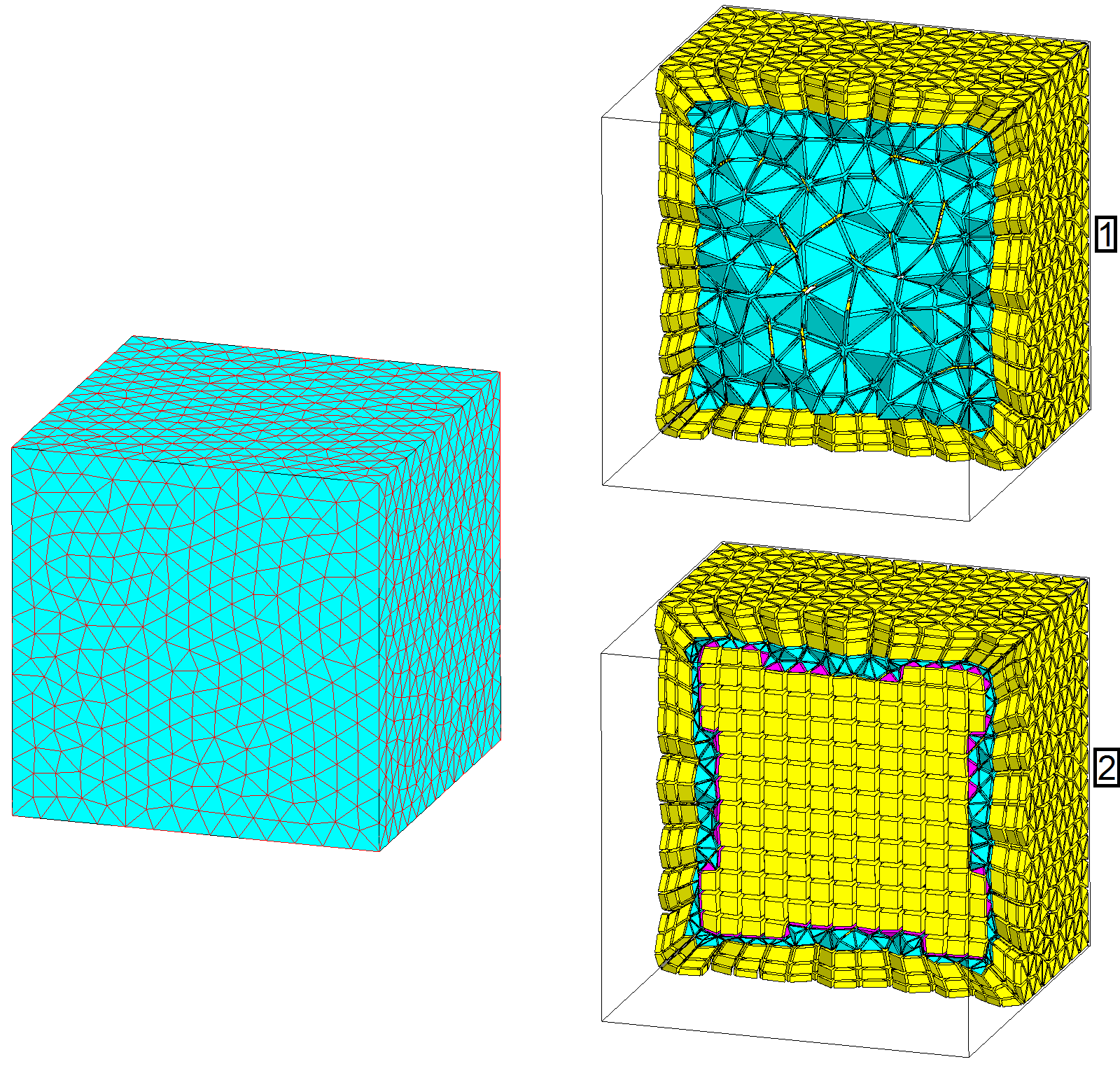

Example
[1] Remaining volume meshed with tetrahedra mainly
[2] Remaining volume meshed with hexahedra mainly

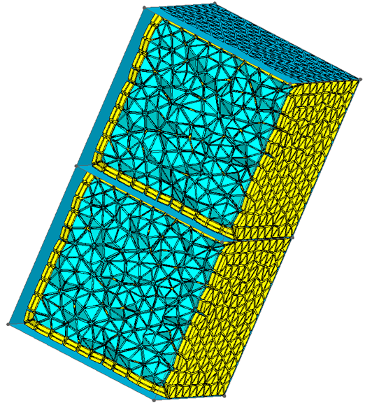

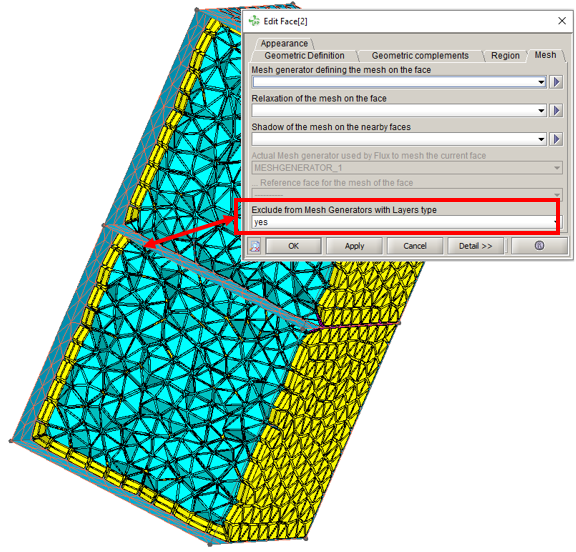

Possibility to exclude faces
By default, the mesh layer is applied of all faces of the volume, even on internal faces. For the physical aspect, it is not necessary to have the skin effect on internal face or symmetry / periodicity plane.
It is possible to avoid the application of the Layers mesh generator in some faces. It will be useful to not have layers on:
- internal faces of a volume
 - boundary faces of a symmetry or periodicity
| Internal face not excluded (NO) | Internal face excluded (YES) |
| The layer are generated around the internal face | The layer is not applied in the internal face |
