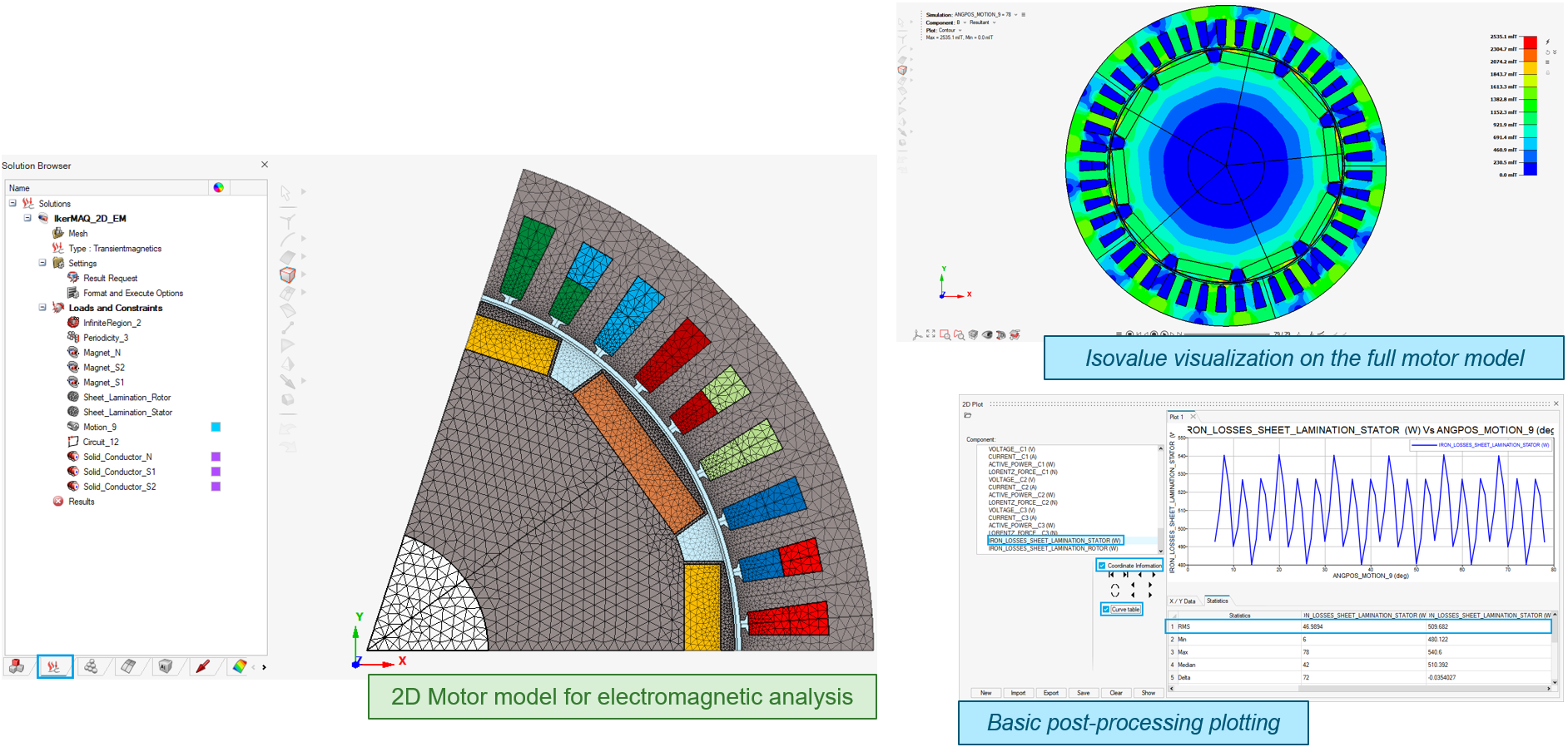

The objective is to calculate electromagnetic torque and other electrical parameters (phase voltages, phase currents, power, losses, etc.) for different rotor positions under transient analysis. In this case, the transient magnetic application is coupled with an external three-phase circuit (created by the Circuit Template) while varying rotor position.

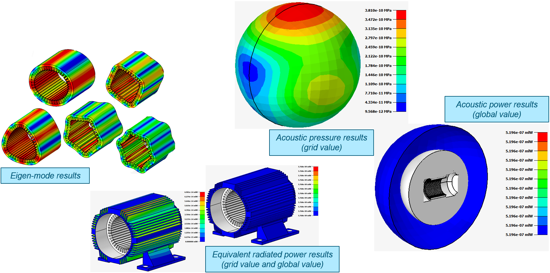

Once the PMSM is electromagnetically computed, the second step is to analyze its NVH characteristics. In Flux, the most common way is to export the electromagnetic forces acting on stator teeth from the transient magnetic analysis and run the NVH analysis with OptiStruct.

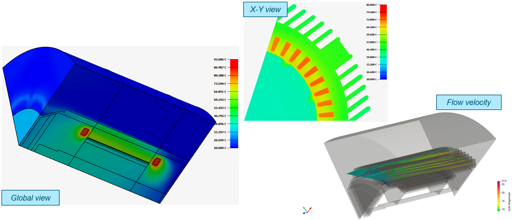

Staring from the 2D transient magnetic analysis, the third step is to analyze its thermal characteristics. In Flux, the most common way is to export the copper loss / iron loss information from the transient magnetic analysis and run the CFD analysis with AcuSolve. The following temperature distribution figure provides a primary analysis of the thermal characteristic inside the motor.
