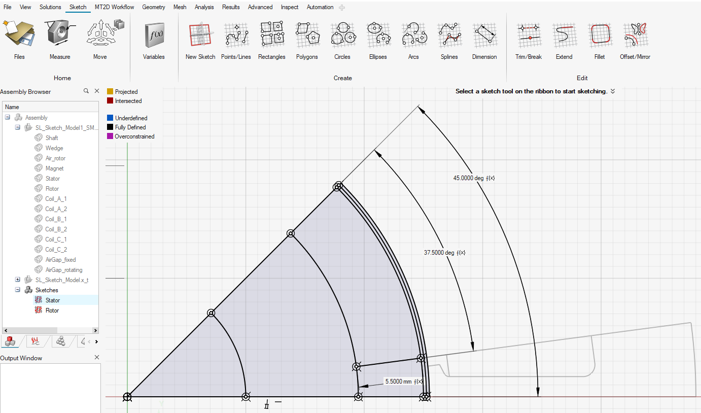

This tutorial shows how to use SimLab to design and run electromagnetic analysis with Flux solver for electric motors. The studied device, a brushless DC motor with surface permanent magnet, includes the following elements:
- a fixed part (stator) including yoke, slots, and windings
 - an air gap
 - a movable part (rotor) with surfaced magnets

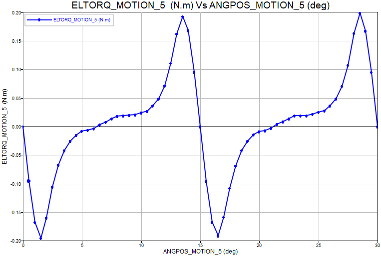

- Analysis 1: Computation of the cogging torque

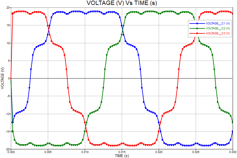

 - Analysis 2: Back Electromotive Force

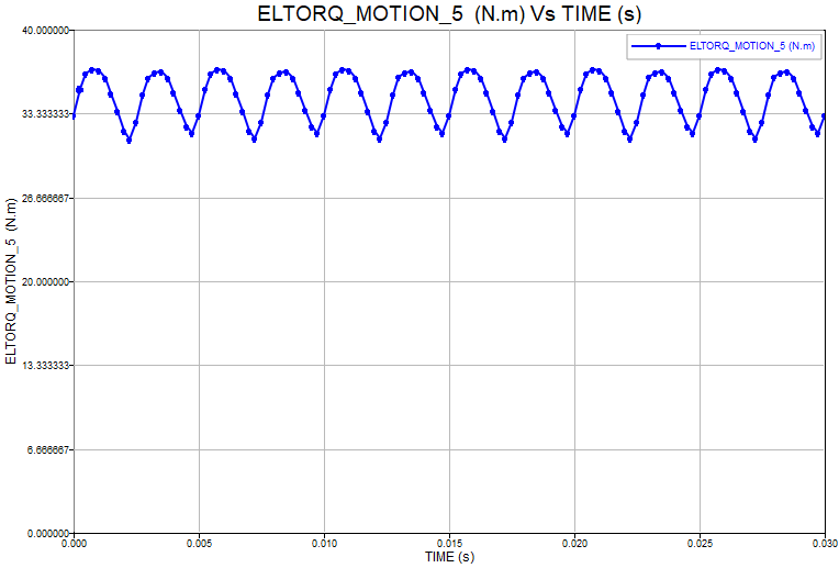

 - Analysis 3: Constant speed
