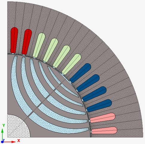

The studied device, a synchronous reluctance motor, is running in motor mode. As presented in the figure in the right, it includes the following elements:
- a fixed part (stator) including yoke, slots, and windings
 - an air gap
 - a movable part (rotor) with flux barriers

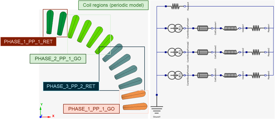

The coil regions are shown in the figure below, and it is coupled with a circuit defined by the [Circuit Designer]:
