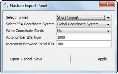

Use Load Export Utility and Generate Nastran Input Deck
In this step you will use the Load Export Utility and generate a Nastran Input Deck.
