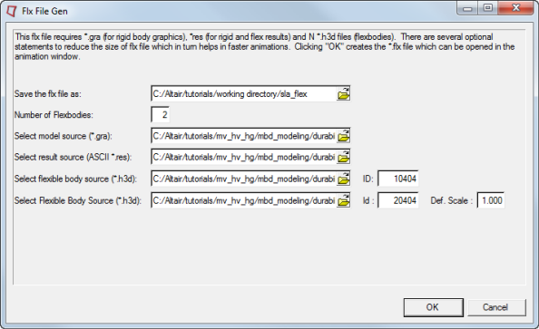

Use the Flex File Tool
Now you will learn to use the Flex File tool.
Start a new MotionView session.
From the menu bar, click Flex Tools > Flex File Gen.
This displays the Flex File Generator dialog. The
dialog lists the files you will need for the conversion.
Use Save the *flx file as and specify the destination of
the file as <working-dir>\sla_flex.
In the Number of Flexbodies field, enter 2 (the model
includes two lower control arms as flexible bodies).
Use the Select model source (*.gra) file browser to
select the sla_flex.gra file from the
durability_fatigue folder.
Use the Select result source (ASCII *.res) file browser
to select sla_flex.res file from the
Use the first Select flexible body source (*.h3d) file
browser to select sla_flex.h3d file from the
Use the second Select flexible body source (*.h3d) file
browser to select sla_flex_m.h3d file from the
Under ID, enter 10404 and 20404
for the two H3Ds respectively.
These values should correspond to the actual IDs of the flexible bodies in the
ADM input deck of the ADAMS solver.
The
deformation of these flexible bodies during animation can be scaled using
the Def. Scale field. In this case, accept the default value of
1.000.
Figure 6.
Click OK.
This will launch the translator and create the FLX file in the
destination directory.
In the Select application list, choose TextView.
On the Standard toolbar, click (Open Document).
Open the file sla_flex.flx.
You should see the following contents of the file: Figure 7.
