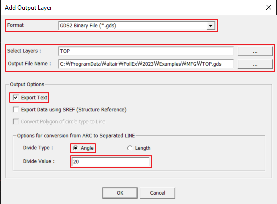

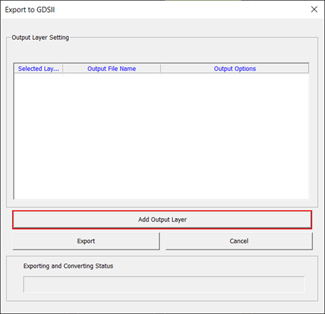

In the GDSII Output Setting dialog, click
Add Output Layer to select the layer
combination to be output.
Set the layers and condition to be output and click OK.

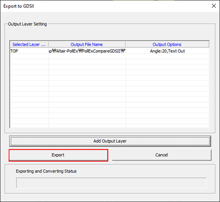

Click Export.
Figure 3.

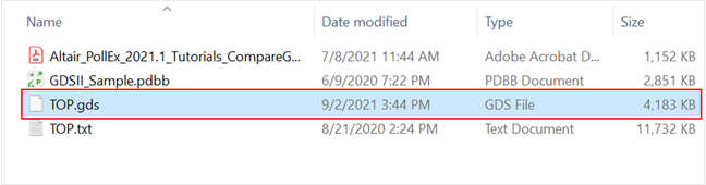

The TOP.gds file is exported to the design
folder. Figure 4.

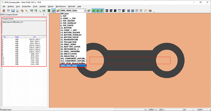

Compared result.
After the comparison, the result window appears on the left of PollEx PCB
Modeler as shown in Figure 7.Figure 6.
When the comparison function is performed, a layer for displaying GDSII
data is added, and GDSII data is input to the corresponding layer. Figure 7.
