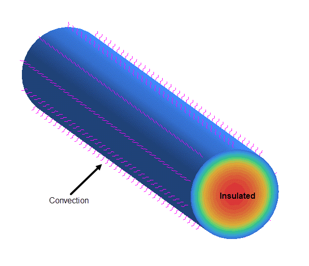

Figure 1. Temperature distribution in the wire
The bare steel wire is generating uniform heat. It is surrounded by an air temperature of 70 F.

The wire is simulated by a 5 inch long cylinder. End surfaces of the cylinder are insulated to allow heat transfer only in the direction perpendicular to the cylinder centerline. Heat dissipation rate was calculated through heat flow rate per wire 1 ft length.
| Reference | SimSolid | % Difference | |
| Temperature at Centerline [deg-F] | 419.9 | 418.6 | -0.31% |
| Temperature at Surface [deg-F] | 417.9 | 416.5 | -0.34% |
